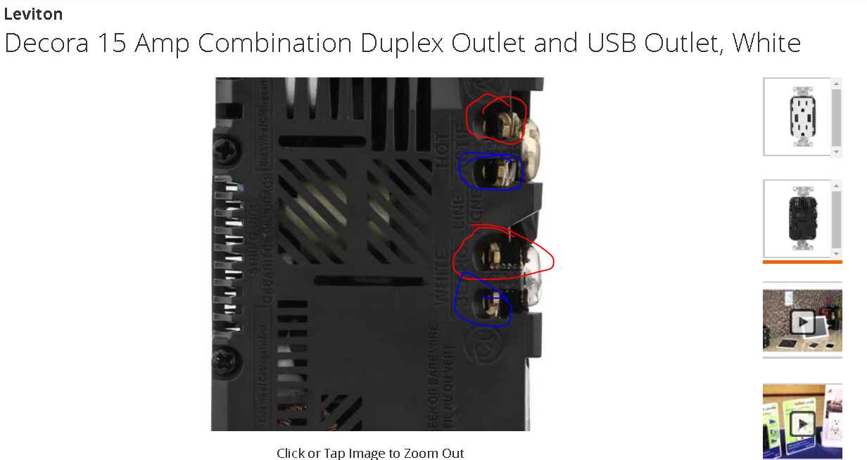

Another electrical question...
I have an outlet a few feet form my kitchen sink that is marked "GFCI Protected" but does not have a reset/test button. It has two hot and two neutral lines (and a ground) so I am sure it is part of a GFCI circuit.
I want to replace this outlet with an outlet that has USB along with a standard plug but I cannot find ANY USB outlets that are GFCI. None.
Is there a way to make this work without disabling the GFCI circuit?

GFCI Protected means that the GFCI Outlet ("load") is feeding this specific outlet. You can test this by pressing the test of the GFCI outlet near it and this should cut power to this outlet. You don't need a "GFCI USB"

Except the current outlet has two hot terminals and two neutral terminals, and the USB outlet only has one of each.

They're just like that to be in parallel with another outlet down the line.
Leviton Decora 15 Amp Combination Duplex Outlet and USB Outlet, White-R02-T5632-0BW - The Home Depot
If you look on the back of this one for example, you will see that there are 2 pairs (4 total) areas were you can insert the existing 2 hot and 2 neutral wires

Except this outlet has two hot terminals and two neutral terminals, and the USB outlet only has one of each.
This is NOT correct for a GFCI circuit, though.

Currently, I think the only way to make this work will be to add a second outlet with USB next to the current GFCI outlet and make sure the USB one is downstream (load) from the GFCI protected one. Didn't want to have to open drywall to add a second box, though.

I'm not sure I understand what you mean by that.. Read my post about GFCI protection.
The 2nd and so on circuits are the ones you're looking at. That's why someone put a GFCI protected sticker on them: they are protected by the one GFCI outlet. If you press the Test button on the GFCI outlet in your kitchen (and it's all wired properly), the remaining circuits should not have power (aka GFCI protected) You adding a new USB outlet or even the Snappower USB guide light or charger plate won't affect the "GFCI-ness" of the circuit.

It has two hot and two neutral lines (and a ground) so I am sure it is part of a GFCI circuit[/b].
Just because there are two hot and two neutral, doesn't mean it's part of a GFCI circuit It means it's just not the last outlet in the circuit and there's an additional parallel run to another outlet. Again refer to above diagram (2nd outlet in the pic)

More than likely, by the way he's described it, the circuit is protected by a gfci breaker... So no outlets with buttons.
OK, thanks.
So if the new recpetacle only has one screw and one place for each wire, I still can't use it without cutting off whatever is downstream, right? Or can I cram both hot wires onto the hot post and both neutrals onto the neutral post? Or would it be better to wirenut together the hots and run a pigtail off it for this outlet and do the same for the nuetral?

OK, thanks.
Check to see if it has two places like the one attached. Or if there's only one 'place' then you can just loop the second one around the terminal screw

Will do, thanks!

Yeah that's a possibility, or there's one with buttons somewhere else in the kitchen
Which is it stogs ?
​​​​​​​Shouldn't matter anyway... If it's a standard outlet, the snappower should fit.

I think ThoiBoi's solution may work. I believe it has room for two wires on each post.

Thoiboi was right, it worked!
