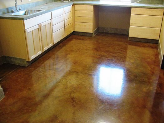

Helping redo a barn for my sister and was looking for a durable finish for the small attached apartment. At the moment, it's a laminate with an unfinished slab bedroom but will take a lot of abuse due to being attached to a horse barn and most likely housing a groom or barn help. I was thinking tile but hate to keep things really straight :ghey: and started to think of DIY acid staining and was wondering if anyone had done it (found a 2008 thread but no first hand experience). Floor prep is key and the back room is a clean smooth slab and the front appears to be too (from the small amount of laminate I pulled up) so that is a plus. I would rent a buffer, get a hand pump sprayer, I have a sprayer for the sealer, and then get some safety equipment (respirator, gloves, cleats, etc).
This site has excellent tips and since I am pretty handy, I figured I would give it a go. Worse comes to worse, I will tile over it
I know you can score lines and use tape to get designs but I'm thinking simple, like below.
Thoughts? Tips? Pics at your house whether DIY or pro?

Looks pretty nice, but lots of messy, dangerous chemicals and it's a really cold floor.
I'd recommend snap-together laminate over an insulation layer. Warmer. Softer. Much less installation trouble than acid or tile.
