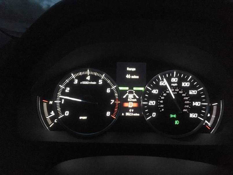

VCMuzzler ***REVIEW***
Sooooo took the car last night out on the highway and all i can say is the car is soooooooo smoooooooootthhhhhhh. no vibrations around 40, 60 and cruising is like its on glass. i guess the VCM use to cause a lot of drive train vibrations. it feels really clean now.
no check engine, no issue with power delivery or loss of power, its feel great. now you can tell when the tranny is ready to shit and up and down just like my 4G, no more nasty vibrations in the wheel.
i like it, im satisfied with the purchase and it eliminated vmc activation

Installation is so easy on both that a caveman could do it. The Odyssey engine cover didn't even have to come off. I could reach the plug with my right hand, hit the release, install the VCMuzzler and away we went. No CEL and no more vibrations. Incredible. The TLX cover did have to come off, but it pops off easily from the four bolt heads/rubber grommets that hold it down. You will see and reach the plug, install the VCMuzzler, put the cover back on and away you go.
So far, I've had a couple days of commuting (city/highway mix) and a 500-mile road trip (highway/expressway). No CEL. I doubted but nevertheless hoped deep down that the VCM was causing the 70-80mph vibrations on the expressway, but alas, the VCMuzzler does not resolve that. I can now say undoubtedly that vibration is the subframe or something that is not the VCM. My car still has that vibration. But what the VCMuzzler did fix was:
-The really bad and really stupid 35-45mph lugging that felt like the transmission was two gears too low. That is indeed VCM. I could feel it deactivate cylinders (stutter), I could feel it while it was running on 3 or 4 cylinders (lugging), and I could feel when it reverted back to 6 cylinders (stutter). That stuff no longer happens on my car. It's silky smooth through that speed range and better yet, pushing the gas yields immediate power. What used to be a seriously delayed response is now instant acceleration and downshifting. VCMuzzler totally restored confidence in passing at these speeds.
-The somewhat bad 57-64mph lugging. This was less obvious vibration but still didn't feel right. It is right in that range I cruised where the speed limit is 55mph. If I set the cruise at 63mph, it would do this ridiculous cycle where it rumbles along on VCM at 63mph where flat. Approaching a downhill, it would coast or run at a really low throttle, lessening the VCM vibrations. At the bottom of the hill and turning back uphill, the car would drop to 62, 61, 60 and maybe 59mph, the car realized it was short on power, VCM stuttered itself off (thus reactivating all cylinders), the tranny would downshift two gears and the car would race back up to 63mph like a dragster. I mean, read that a few times, then tell me that sounds like something you'd expect from an Acura. My God. I'd expect better from a Yugo. Now with a VCMuzzler. I tested this exact situation and guess what - it doesn't happen. The V6 has enough power that it holds 63mph stable downhill or uphill. This engine is remarkably powerful in it's natural state. For instance, it solidly holds 63mph at 1400rpm in 8th gear on flat roads or minor upslopes, and it solidly holds 79mph at 1700rpm in 9th gear regardless of any wind or slopes. If the car does need to downshift for a higher grade uphill climb, it does so immediately and without any VCM delay or deactivation stuttering. Surprisingly, the ZF9 actually responds faster and feels better with the VCM muzzled. It hunts for gears much less while cruising and shifts faster when required. It makes me think the ZF9 is getting a really bad rap as the perpetrator behind the underwhelming TLX driving experience when the real bad guy is VCM. My two cents after muzzling for a few hundred miles.
VCM and deactivating cylinders obviously robs power. Maybe it's acceptable power for coasting, but not good for power on demand or throttle response. Restoring said power means 1) sensing the car needs more power 2) going through cylinder reactivation cycle and 3) shifting appropriately to accelerate as needed. No matter how much you try to perfect such a system, it will result in activation shaking and delayed throttle response. Those are inherent traits and ramifications of such a system. I happen to fundamentally disagree with the philosophy that half an engine should ever be shut off. That is why I muzzled. My proof is in the pudding. I now have a powerful, silky smooth engine at 38, 63 and 79mph. What frustrates me so much is that Honda has an outstanding V6 engine here - but the silly, imperfect VCM is absolutely abusing it. Maybe my rings will fail, maybe they won't. Maybe my plugs never would have fouled and misfired. But muzzling has to be better than letting VCM operate unchecked. Now if only I could fix the expressway vibration...
PS it was single digit temps during my road trip. I have run the blue resistor since I installed the VCMuzzler. That should work all year, but verbatim sends the whole gamut of resistors. I received my package about two weeks after ordering. Most of the time is due to Canada-USA customs. Verbatim deserves a lot of credit for fixing Honda's mistake. My TLX and Odyssey both demonstrated the same improvements. My temp needle sits at about the bottom of the thermometer symbol.
