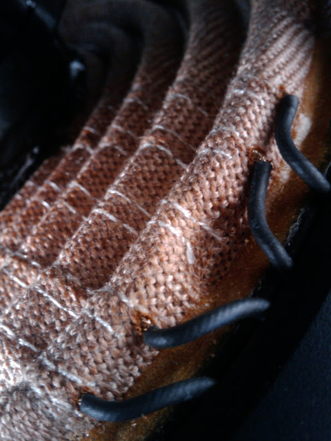

well I took the sub out of the box today to check the tinsel leads and this is what I found
It appears that the leads are woven directly into the spider so I cannot really inspect the leads that well or do any repairs if it was loose/fried.
I did push into the spider where the leads were and the sub turned on then stayed on. Haha. I played a couple of songs to see what would happen and everything seemed fine. No cutting in and out or static. So as of now I have it back in the box and hopefully that "fixed" the problem. lol.
Thanks for the help guys. I'll report back tomorrow to say if it's still working. If it turns off again I might have to take it in to a repair shop.
