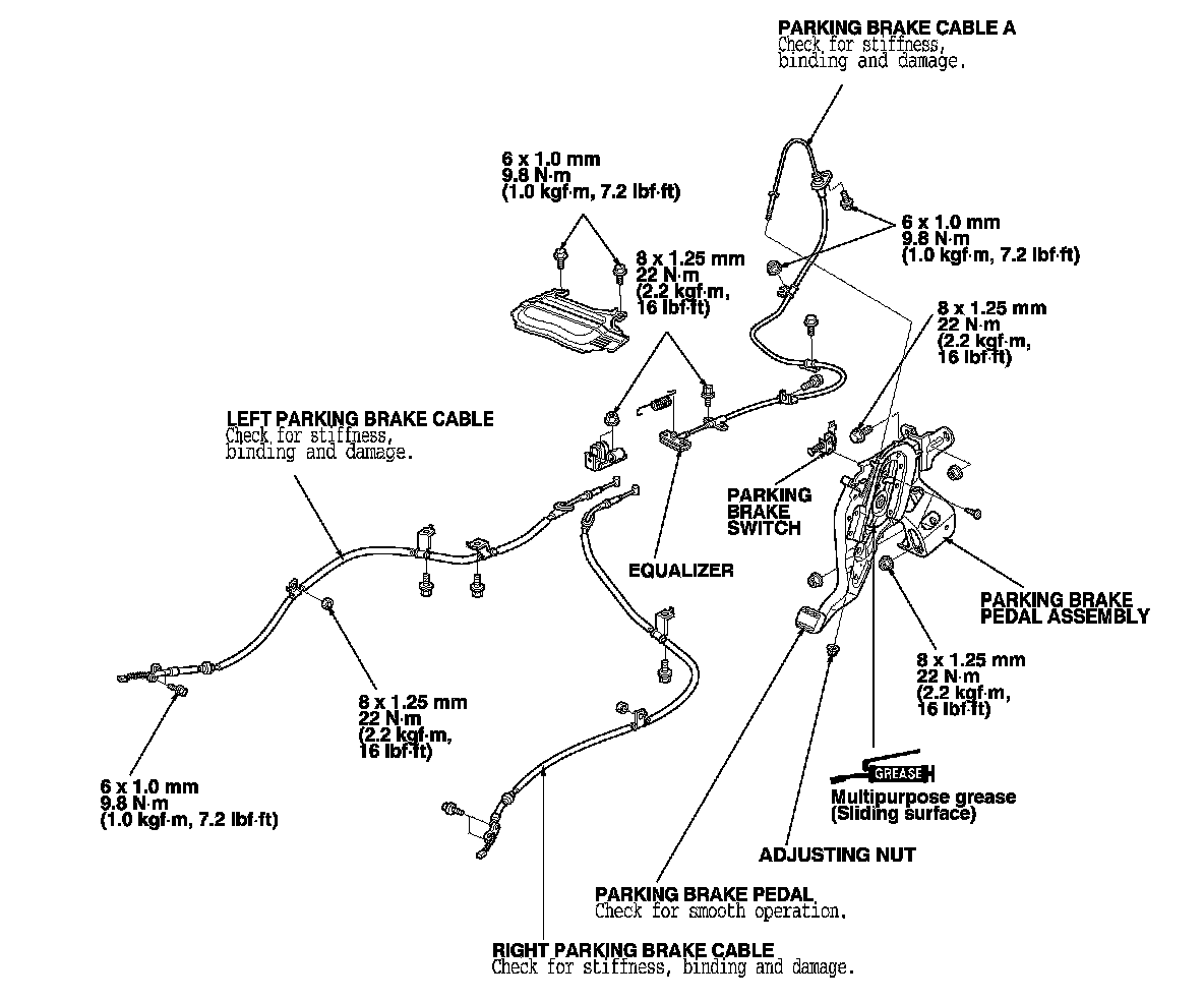

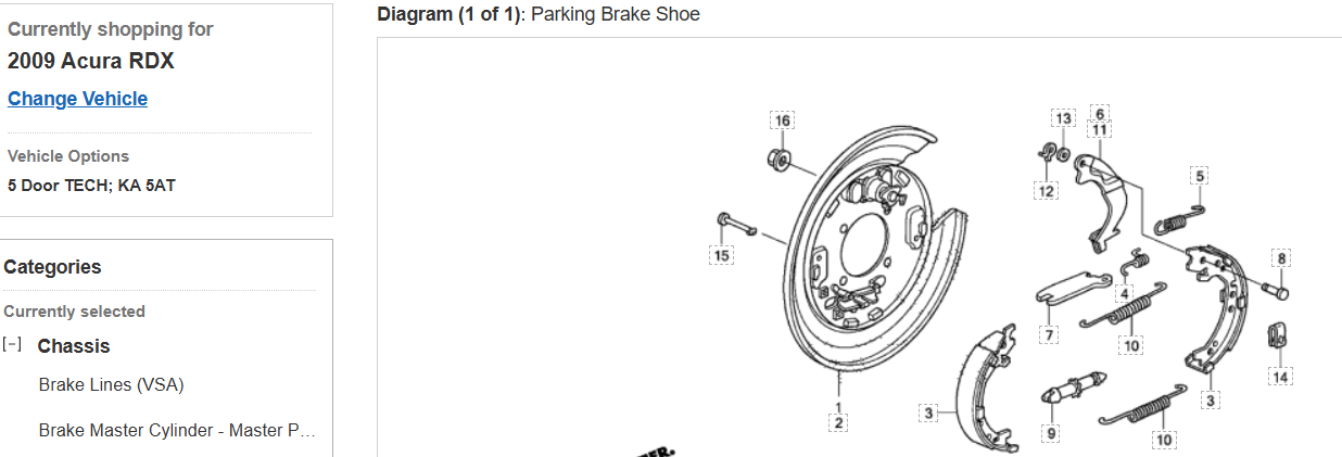

Do you see, what you refer to as the PB equalizer, on on either of the parts diagrams below?
If so, which number is it?

I believe it's #3. I'm replacing #7.

It appears you will have to replace #3 parking brake wire (A) as an assembly to get the 'end piece' (equalizer) lower purple arrow.
The two round ends (upper purple arrow) of #5 & 7 PB wires would fasten into the 'equalizer' on the distal end of #3 PB wire.
Refer to the link for the part number & price. I plugged the part # into rockauto.com and found no aftermarket equivalent.

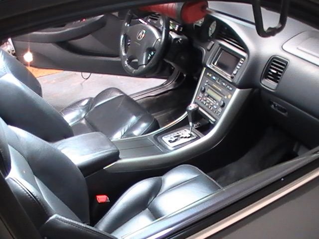

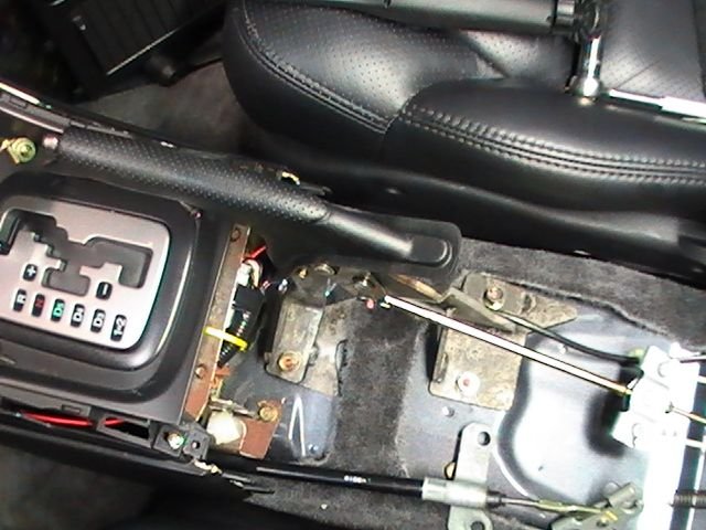

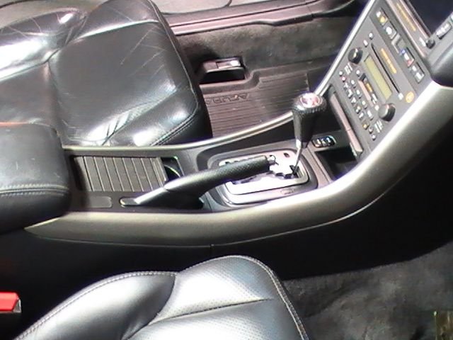

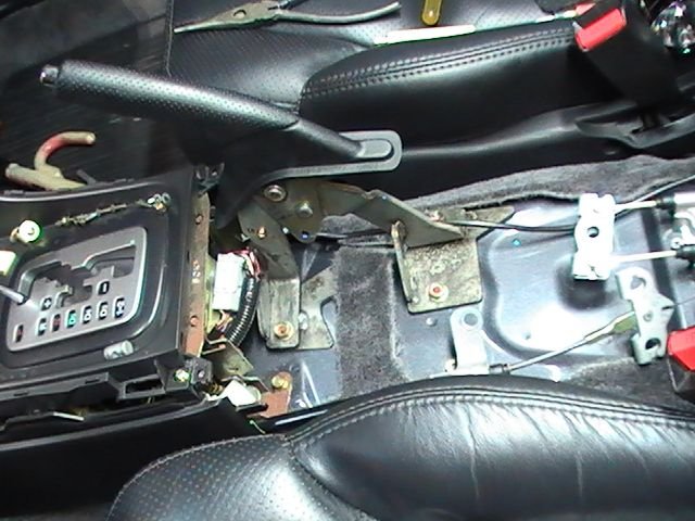

Therefore, from my past experience of 'swapping' in an Acura CL-S six speed center console manual transmission parking brake lever set-up into my automatic CL-S interior, I would venture to guess that the 'equalizer' distal end of #3 would be located under the carpet / center console area just before where you say the PB cables enter the cabin from under the car. Requiring, at least some level or complete center console disassembly to get at all related connections.
Here are a few pictures of what I encountered:
Before:
After:
Parking Brake Cable Replacement
