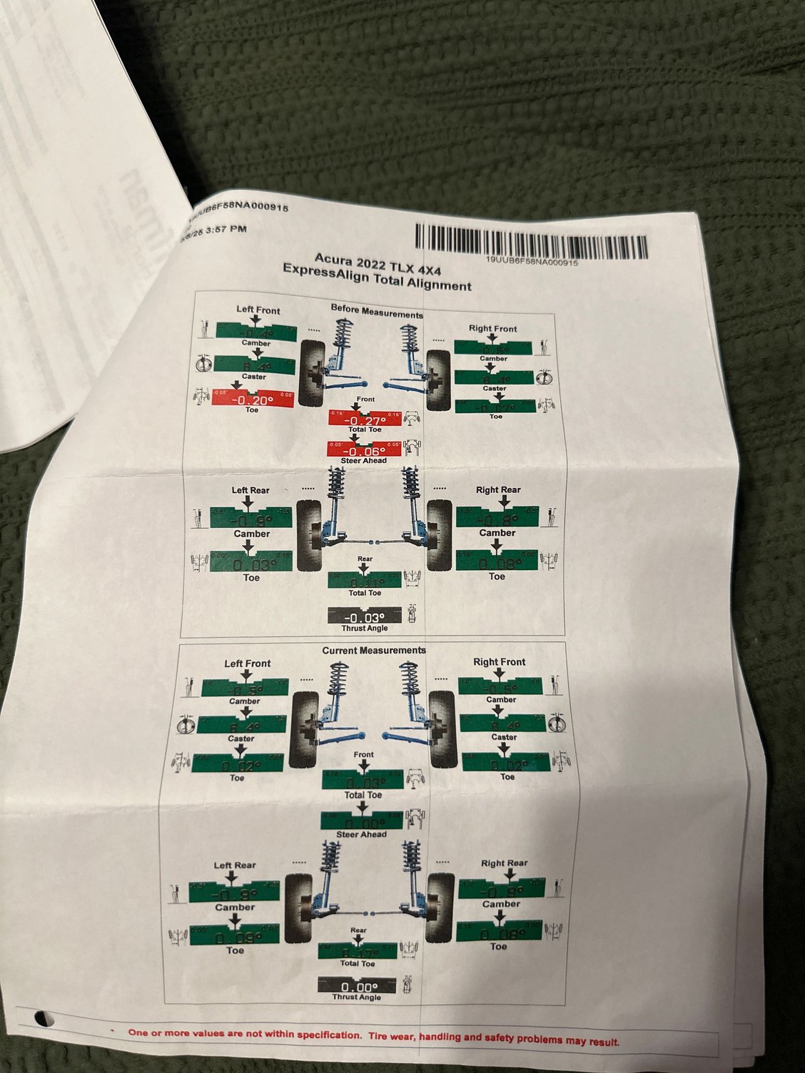

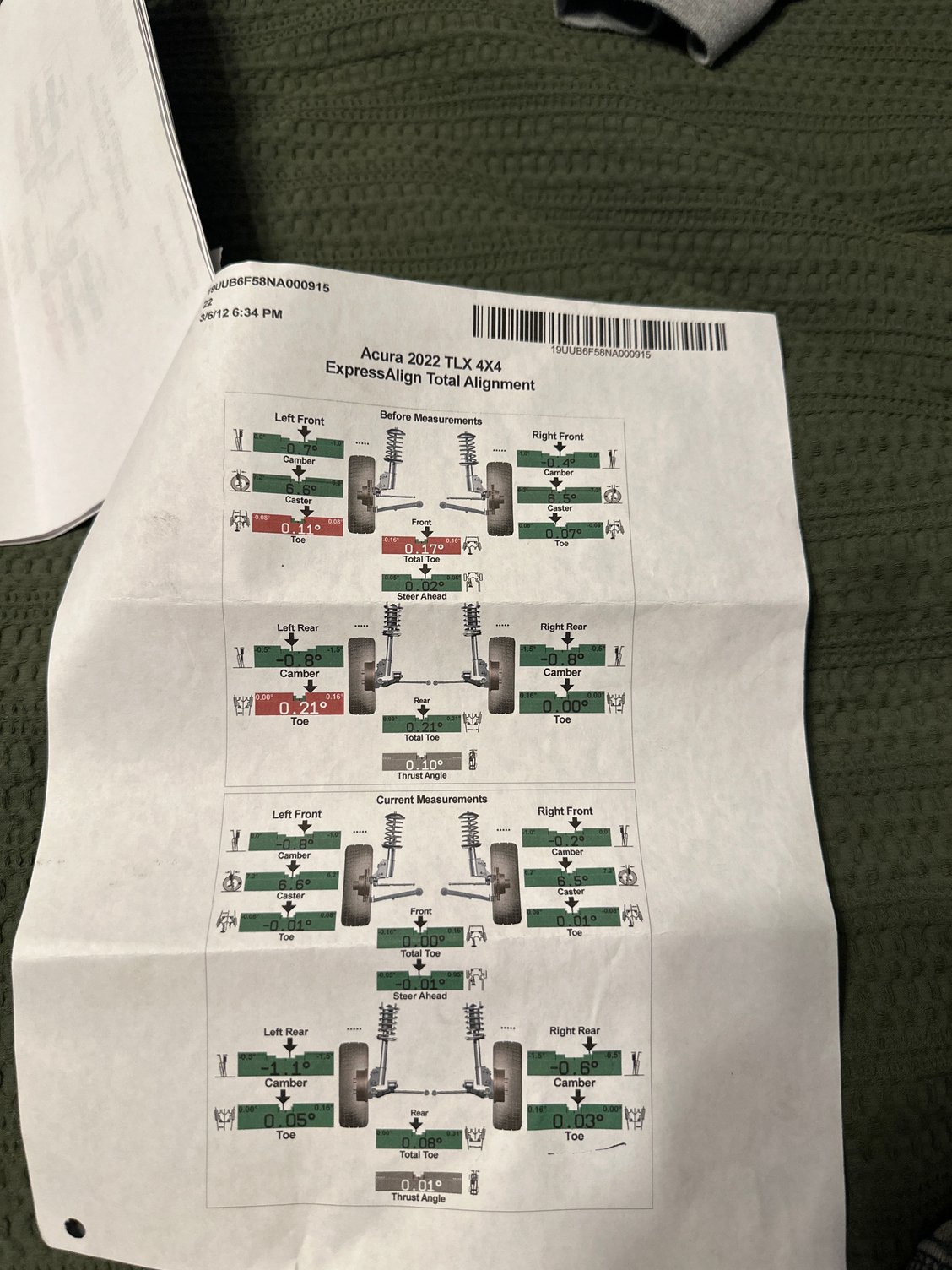

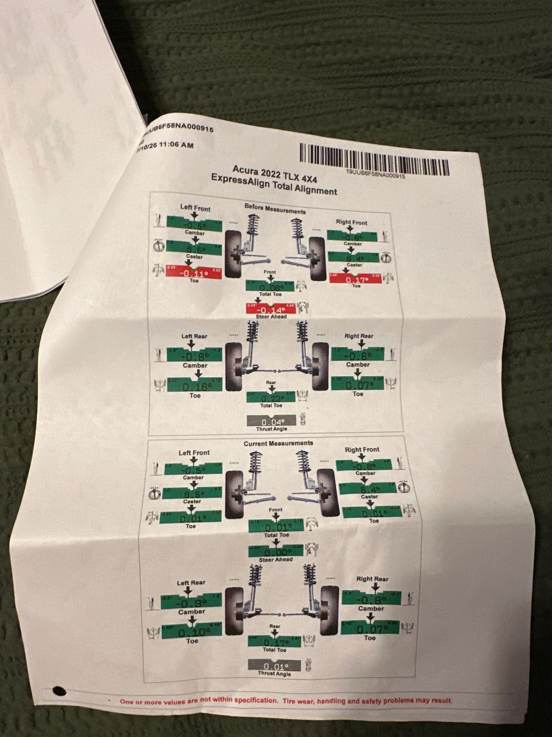

Hello everyone! I have a 2022 TLX Aspec with SHAWD and back in may I got new tires mounted (Extremecontact DWS06*) at around 51k miles as well as an alignment performed. I bought the car 2nd hand as a lease vehicle and went through every service record and no prior alignment had been done to the car. Ever since then, the car has been pulling to the right. I took it back to my local dealer and it’s had multiple alignments and each time the toe and/or the steer ahead is way off to either the left or right. They said they can’t duplicate the issue after a steering angle sensor relearn. So I took it to my local honda dealer, the pulling was duplicated immediately and the only issue with the suspension they could find was the toe adjustment tab was slightly bent on the rear right of the car and said it wasn’t allowing it to get fully into spec. I took it to another Acura dealer an hour and a half away and they said the same thing. Issue duplicated immediately, they swapped the wheels from another TLX onto the car to prove the tires and wheels aren’t causing it and quoted me 3k for a new rear subframe and said that it may not even fix it. After getting the run around again, i’m taking it back to my local dealer for the 5th time since may to go on a 2nd test drive with their service manager and this time a master tech is supposed to come along as well. Has anyone had any similar experiences or idea as to what could be causing it? Here attached in order are the alignments.
