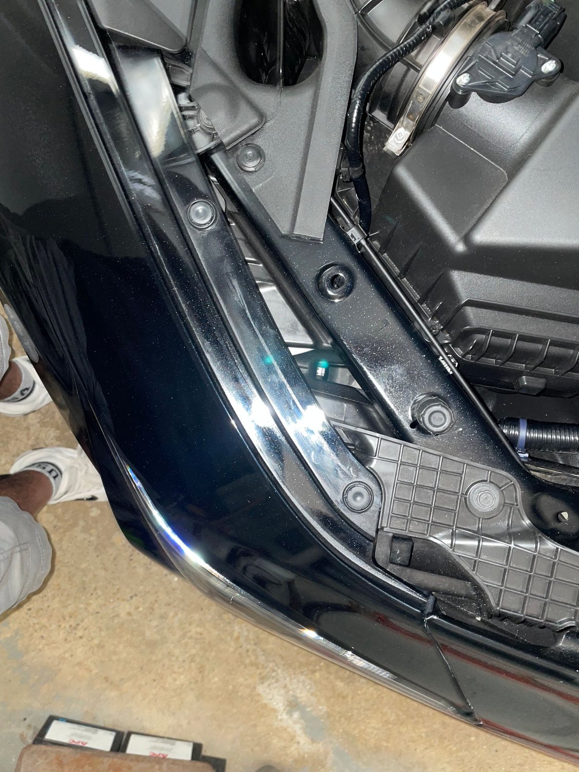

The first photo I sent you was blurry, try zooming into this one. You should see the metal adjuster
