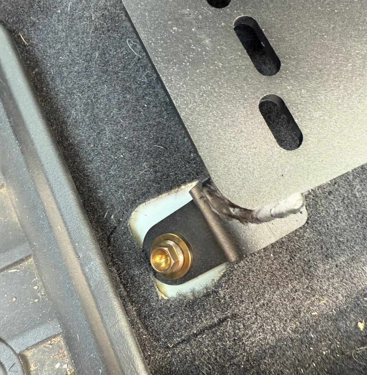

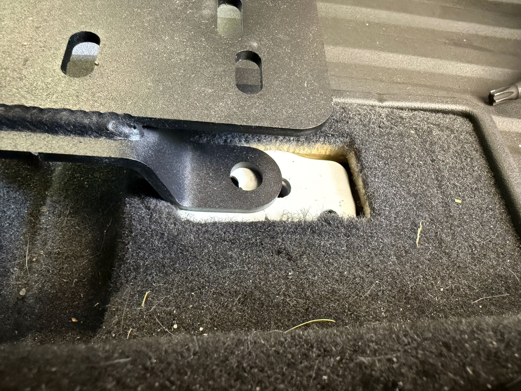

Hey everybody, so I finally had some time to take the Driver seat out of the Type S and try the 18+ Honda Accord seat bracket that I got from planted technologies.
Even though these are not Honda Accord based, I figured some parts may carryover. In the measurements were pretty darn close. I got this thing last year, but just haven’t had the time… Until yesterday.
So I pulled the seat out, installed the bracket and… It fits! Well, almost. The rear mounts are about half an inch too short. So I reached out to planted, and they are making a TLX version of the bracket for me.
So if anyone is interested in putting a racing seat in their TLX? There is something available and then something more specific coming down the pipe.
For now, I’m going to cut out the rear mounts and put a larger washer to secure it temporarily. I did remove the rear seat and will be using the rear seat belt mounts for the harness.
I’ll be going with a Braum Racing carbon fiber, racing seat, at least on the driver side for now. For track use. It’ll give me a little more headroom and a lot more support!
keep you posted!

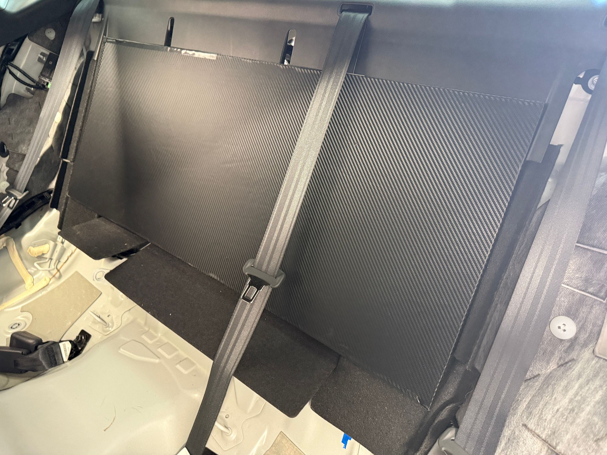

Was getting rid of the rear seats a significant weight savings? By any chance did you weigh the driver and passenger seats to see how much each seat weighs?
Old Jun 2, 2025 | 01:07 PM
TypeSbuilder's Avatar
Joined: Sep 2024
Posts: 168
Likes: 84
From: CLE, Ohio
The rear seats aren’t that heavy in general. The seatbacks are but not the bottom or the side pieces. But I’m guessing probably 60+ pounds… Maybe 70+ pounds?
The front seats are pretty heavy though. I’m thinking probably 60+ pounds each? I will try and weigh those when I get the next one out.
The new racing seats are in the low 20 pound range. So overall you’re saving quite a bit and I really pulled the rear seats out just for mounting options for the harness. And I don’t use it lol so it looks cool.

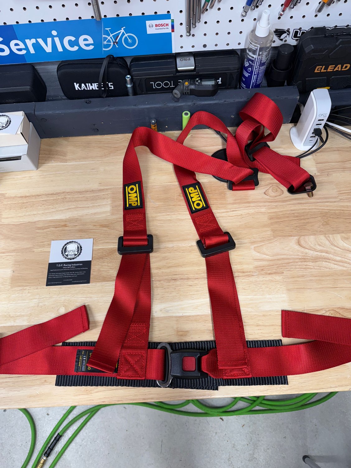

Old Jun 9, 2025 | 07:33 AM
Joined: Sep 2024
Posts: 168
Likes: 84
From: CLE, Ohio
OMP in the house!

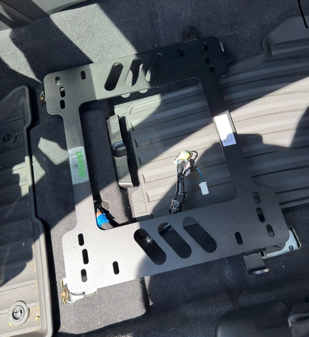

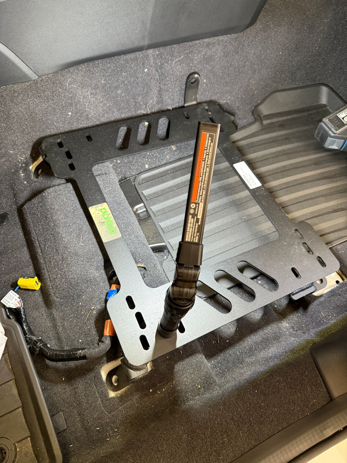

Old Jun 15, 2025 | 01:41 PM
Joined: Sep 2024
Posts: 168
Likes: 84
From: CLE, Ohio
Old Jun 15, 2025 | 05:46 PM
caLiTLX's Avatar
Family Hauler
Joined: Sep 2021
Posts: 252
Likes: 183
From: 626 - California
Very nice, is that the TLX specific bracket?
Old Jun 15, 2025 | 07:11 PM
Joined: Sep 2024
Posts: 168
Likes: 84
From: CLE, Ohio
yes!!!

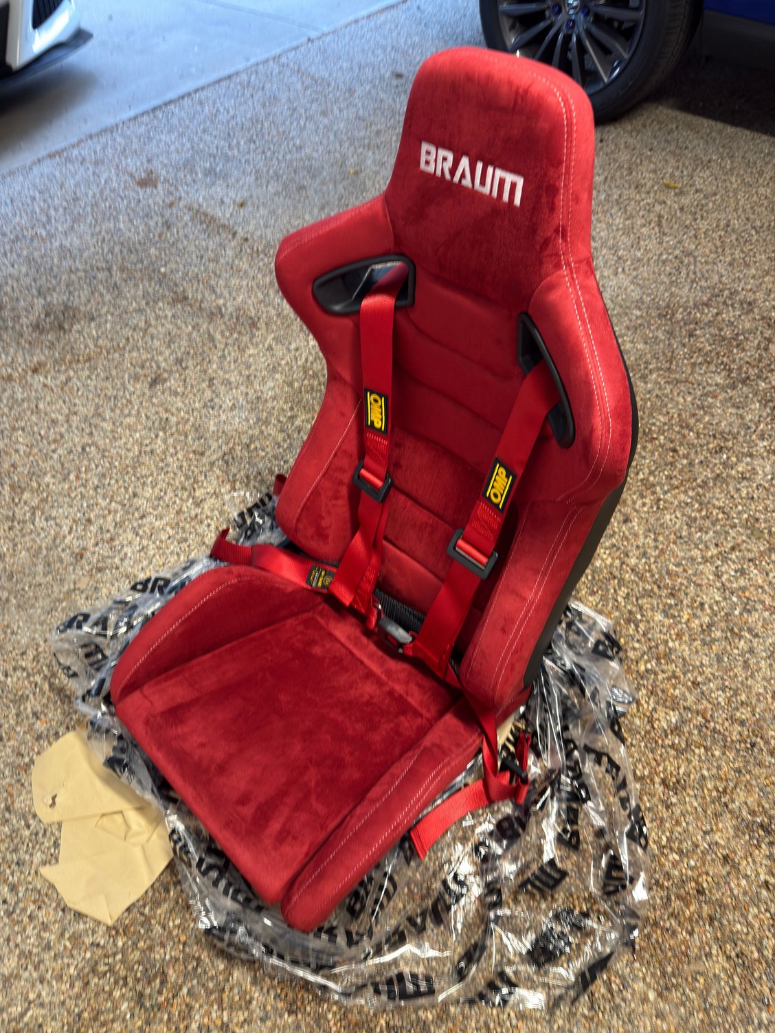

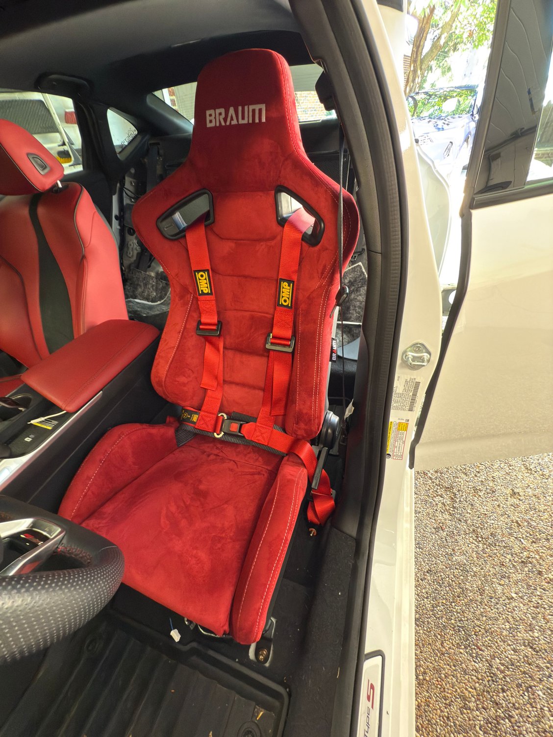

so a quick update… The Braum Racing seats came in today! So guess what I’ll be doing tomorrow… I’ll have some pictures shortly but still working on the electronics part not too worried about the SRS. It’s the chime that I’m trying to figure out how to disable without having to rewire the whole damn thing… I.E. factory wire harness and disassembling some of the factory seats…
Old Jul 3, 2025 | 02:26 PM
visi_d's Avatar
Joined: Dec 2017
Posts: 390
Likes: 148
From: Macomb Michigan
Are you going to run a harness? The chime will be from your seatbelt latch. You will reuse that. Depending on the style seat you went with you might need that latch arm extended. I did this custom arm with my seats since i didn't run a harness
Old Jul 3, 2025 | 02:30 PM
visi_d's Avatar
Joined: Dec 2017
Posts: 390
Likes: 148
Old Jul 3, 2025 | 02:52 PM
Joined: Sep 2024
Posts: 168
Likes: 84
From: CLE, Ohio
Originally Posted by visi_d
yes, running harnesses, the only issue is that the seat belt buckle is attached to the seat so it’s gonna be taken apart, thinking of picking up a wire harness from a factory seat just to see if I can plug it into that and then just plug it in behind my racing seat. Working on everything at this point, but thanks for the info.
Old Jul 3, 2025 | 06:06 PM
visi_d's Avatar
Joined: Dec 2017
Posts: 390
Likes: 148
Seat belt attachment
Should be able to attach here where circled in red. The latch arm
Old Jul 3, 2025 | 07:14 PM
Joined: Sep 2024
Posts: 168
Likes: 84
From: CLE, Ohio
that’s where the harnesses are mounting. Once they don’t have holes on the center console I had an additional one put on the bracket itself.

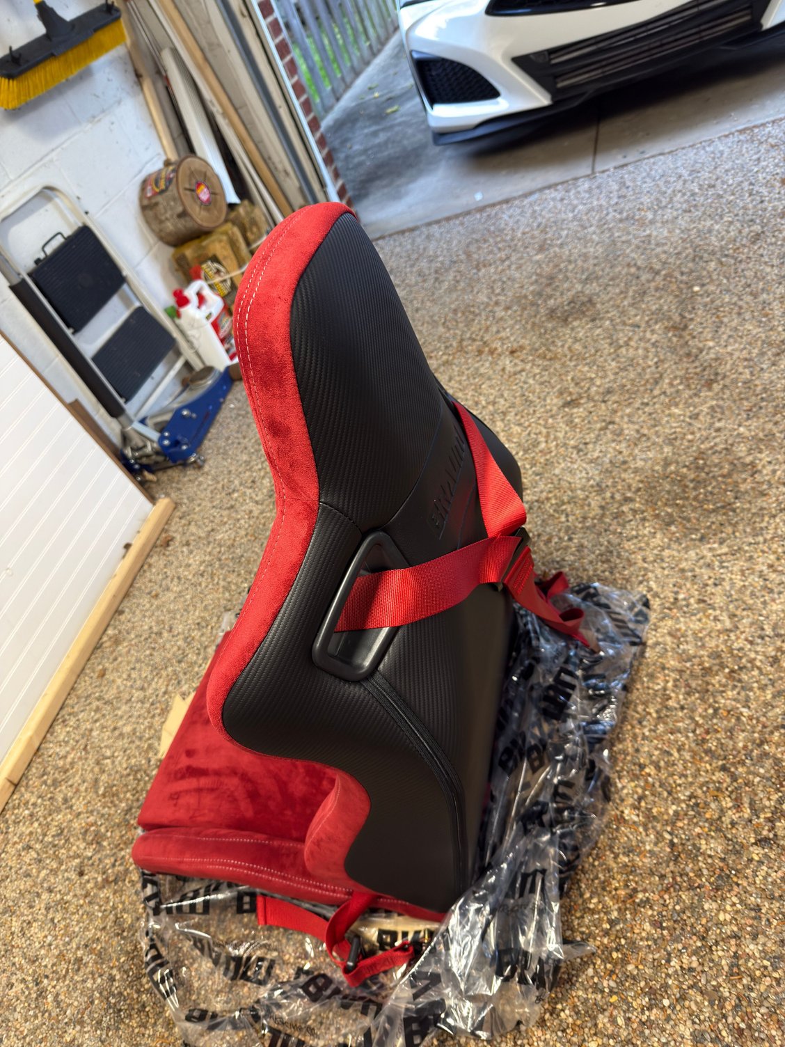

Old Jul 3, 2025 | 07:29 PM
Joined: Sep 2024
Posts: 168
Likes: 84
From: CLE, Ohio

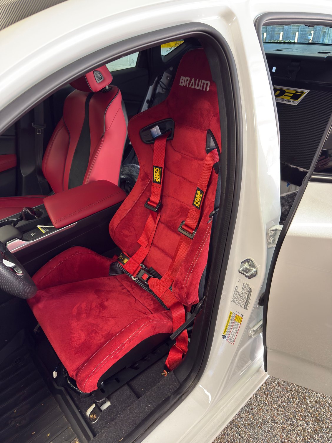

Old Jul 4, 2025 | 05:18 PM
Joined: Sep 2024
Posts: 168
Likes: 84
From: CLE, Ohio
Done!!!
Old Jul 4, 2025 | 05:19 PM
Joined: Sep 2024
Posts: 168
Likes: 84
From: CLE, Ohio
And?? Best part? The seat belt chime wires are a separate, small, harness! Undoing it tonight and won’t have “Binging”!!!!
Old Jul 5, 2025 | 05:29 PM
caLiTLX's Avatar
Family Hauler
Joined: Sep 2021
Posts: 252
Likes: 183
Nice! Seat looks great. Did you get any weights on the new setup versus the OEM seat assembly?
Old Jul 6, 2025 | 08:26 PM
Joined: Sep 2024
Posts: 168
Likes: 84
From: CLE, Ohio
Thanks!! I have one of those 'hanging' scales and did my best...saves right about 24lbs per seat! SOOO much lighter than factory.
