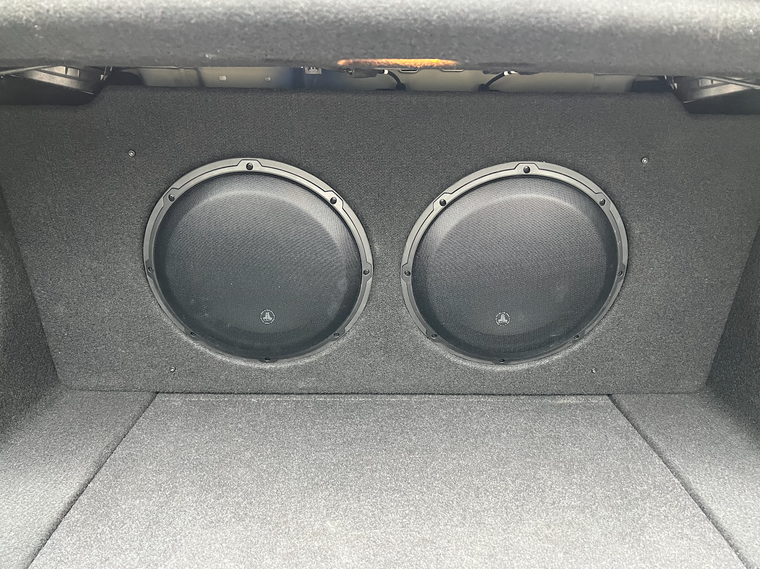

Yep had the same issue with mine, bass came mostly front and was a little clappy sounding. Went to a professional audio shop and had a few 12's put in. Plenty of bass back there now.
Everything seems to work well, subs allowed me to turn the system bass down so those front speakers weren't clapping anymore but the back fills in nicely for it, had them do a custom box to and they were able to fit it perfectly so the entire back spare/battery area is accessible so another shop should be able to replicate something similar.

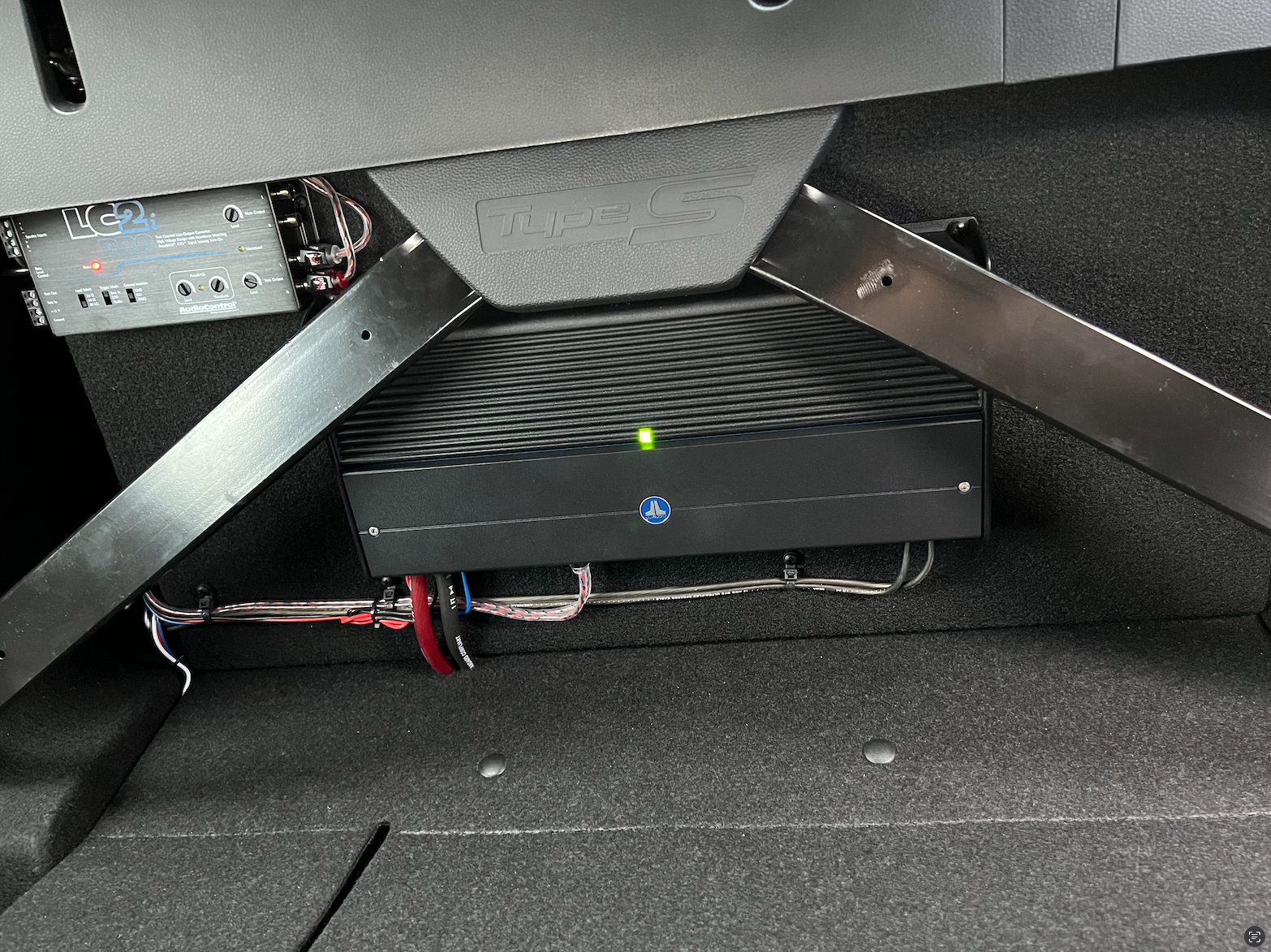

Sure. Here's how it turned out. I unfortunately don't remember exactly how much the box was, everything altogether was like $4500 and I think the box alone was $1100. It was a lot of labor, wires were ran to pre-amp for the cleanest source and not just tapped into the back subs. Subs are JL W3's, 1200W Amp, LC2i Pro. Sounds fantastic and I still have the majority of my trunk.

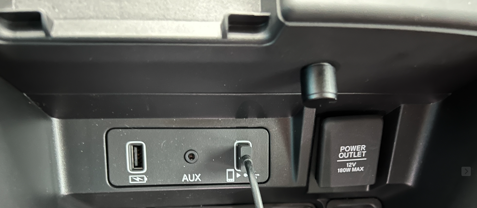

Oh and they added a nice little dial in the center console (where I requested to keep it out of view) so I can independently adjust the subs or turn them off completely.

I think it's worth having a shop go pre-amp though, sub taps puts you at the mercy of the factory amplifier which just isn't going to get you the full range of what aftermarket subs can output being tuned for the comparably tiny subs in the rear deck.
