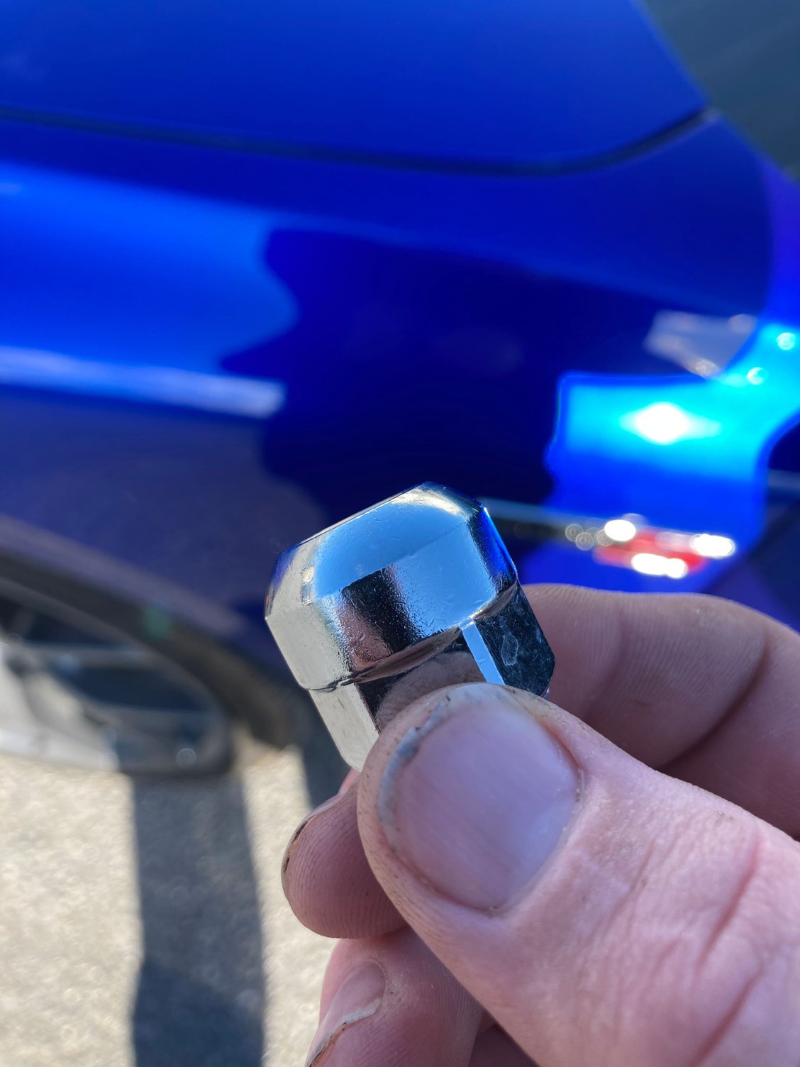

Ive read a few things about the TLX’s lug nuts being radius (rounded) rather then conical. I was going to check but apparently i need to purchase a 22mm socket. Just thought id post this on here to see who knows, lots of people will be putting on winter wheels soon and you would hate to see someone try to use the stock lug nuts on an after market wheel that is conical or vice versa.

Forgot i had spares from putting on locking nuts, Can confirm they are radius
