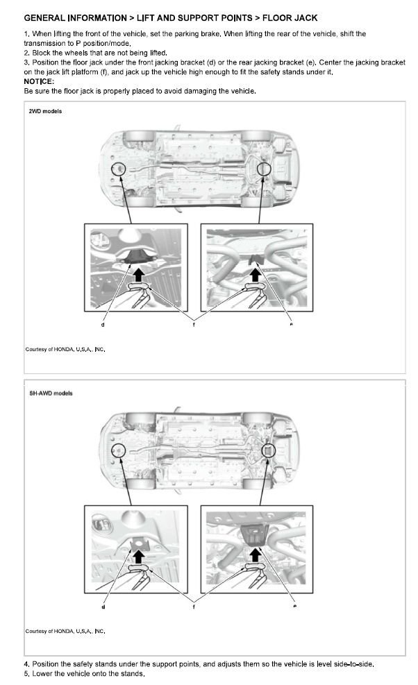

You can't miss it. Here's visuals from under the Type S, same floor jack points for 2.0TDGI (K20C) as well, forward one is in front of the strike plate BDC, and aft is behind the rear diff.

Now that it's almost time for winter tires, just to confrim @praecisiovectura excellent post on front/rear center jacking points, further confirmed in the service manual (but not mentioned in the owner's manual, strangely)...
