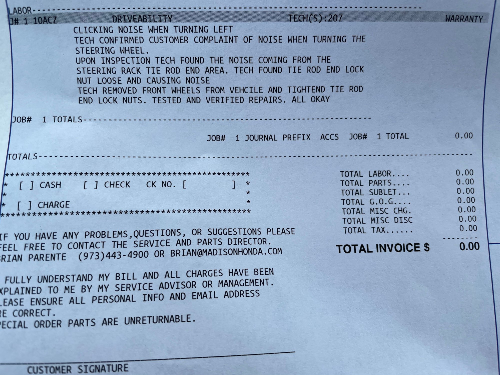

I have the issue with my 22 MDX. Dropped it off with my dealer this morning. Dealer left a message that the issue was confirmed and fixed. Will report back tomorrow as to what was done to remedy this. (May put this off until Monday as I’m enjoying the RDX A-Spec loaner. )
Old Oct 30, 2021 | 09:38 PM
F23A4's Avatar
Joined: Sep 2002
Posts: 18,018
Likes: 1,737
Here’s the finding/remedy:
Old Nov 1, 2021 | 10:15 AM
loki's Avatar
Posts: 627
Likes: 477
Loose tie rod end lock nut? I honestly hope that's not the cause for everyone that's having this issue. I have replaced dozens of tie rods in many of my past Acura and Honda cars and to think they're loose from the factory is mind-boggling. These tie rods are not the ones from the 90s where ball joint is bigger than the opening so even if there's play in it, it can't come out. These fall right out if not 100% tight and no play; and there goes your entire wheel assembly out.
