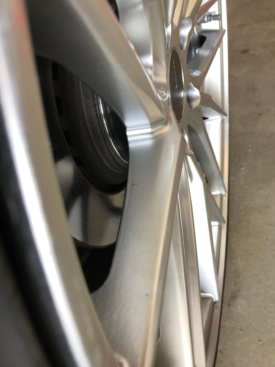

Installed 1 week ago Advanti DST Catalan 20x8.5 with 42mm offset and Extreme contact DWS 06 245/35ZR20
Driving impression: Just as comfortable as the previous tires and rims. More road feel in a good way. Braking improvement is amazing. I didn't complain about it before but I tend to forget how much good tires can affect braking. I love the way they look and handle the road.
Notice the better camber and with the wider wheel it is more flush but not quite complete

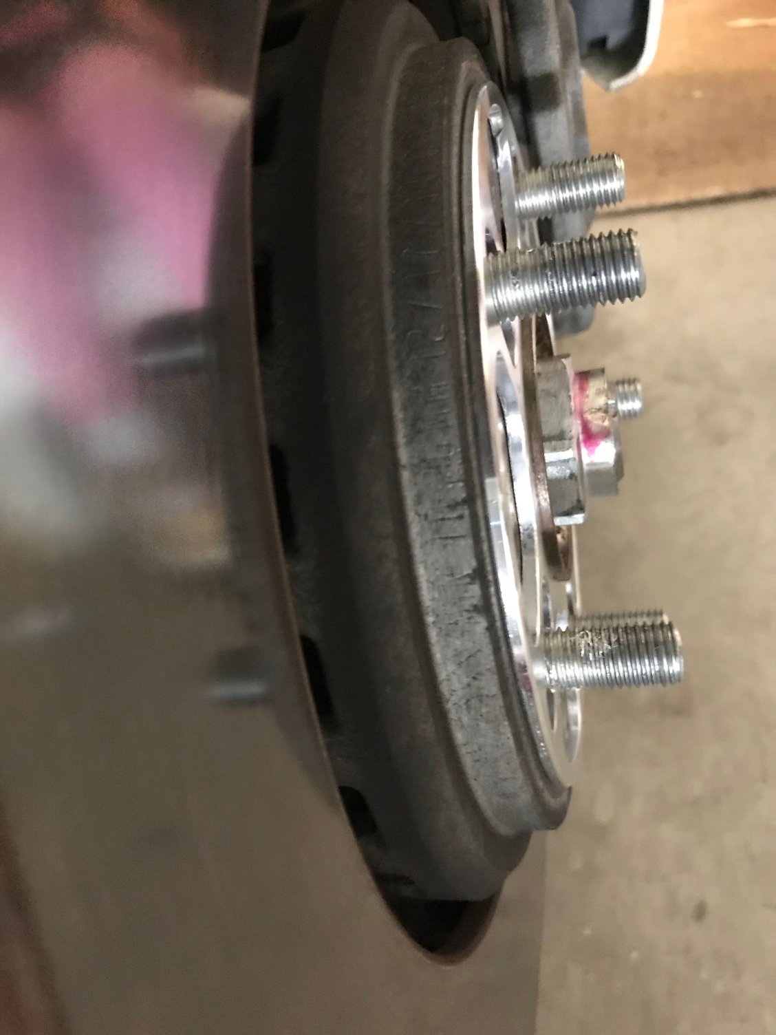

Hubcentric 5x114.3 (64.1 bore) 3mm aircraft aluminum spacers for the front by Euro Motor Werkes. Anything more than 3mm would require longer studs.
Eight prince (made in Japan) 15mm 12/1.50 5x114.3 6061 aluminum with heat treated carbon steel studs. For the rear wheels
hubcenteric rings 64.1mm bore
put together for a tight fit
rear of rim. Notice the gaps for the wheel stud to go into that extends past the spacer
Front rotor without spacer and as a side note the studs measure 27mm in the current photo.
3mm hubcentric spacer installed. Firm fit around hub
From side. Applied anti seize to reverse side
front installed 3mm spacer
Eight Prince spacer installed after cleaning hub and applying anti seize to reverse side. As you can see I have blue lock tight on the stock lug threads
torques to 85lbs
After install and torques 30.5mm eight prince threads to 85lbs. notice the space provided for the stuck thread to be so it doesn't hit the rim
Finished product. 1 tight index finger between front tire and fender and 1 loose fit index finger between rear wheel and fender
