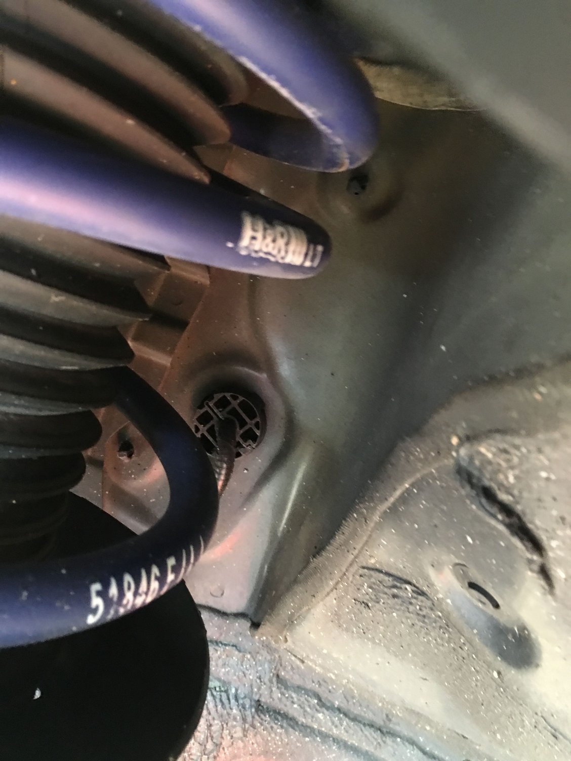

So I finally found what the problem was. The coils from the springs are rubbing against each other causing the noise. Currently waiting a response from H&R too see what they tell me. You can see when the car is lifted and the springs are uncompressed where the springs are rubbing. Also when the springs are compressed you can see they touch against each other.
With the spring uncompressed you can see where it's rubbing

From: Southern California
Are you sure your installer put the springs on correctly? The springs rubbing that much is definitely not normal. Looks to be installation error or the wrong springs or something
Yeah the springs are installed correctly. The lettering is facing the right way. And its seated properly. The Part number on the springs also match the part number for my car. It also makes sense that i wasnt getting the noise right after the installation. Because the springs werent settled yet. So as they settled thats when the springs started rubbing.
