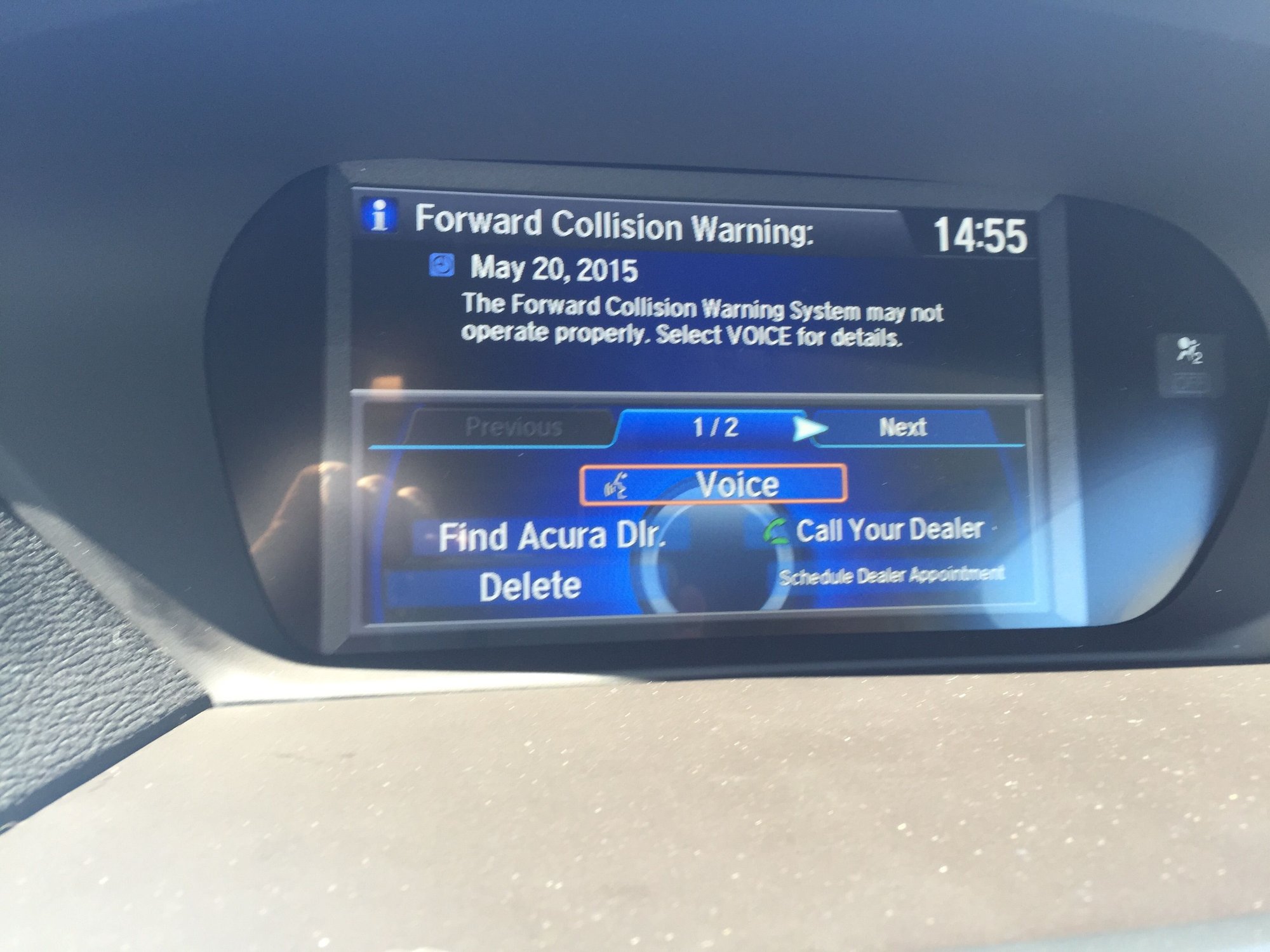

I noticed something today with the warnings I started getting yesterday(lane departure and forward collision warnings)
If I stop the car, put it in park and then shut it off I don't get the warnings.
If I stop the car, shut it off before I put it in park (accessory mode), the next time I start it and drive I get the warnings after about a minute or two of driving.
Yesterday was the first time that I saw these warnings and coincidentally the first time I tried accessory mode by shutting the car off without putting it in Park first.
I'll mention this to the dealer the next time I'm in for service. I just thought I'd mention it in case others have seen this.
These are the warnings I got.
I get these warnings about twice a month. It's pretty annoying, random, and I've had my camera and TCU replaced already. I always put my car in park before I shut it off.
