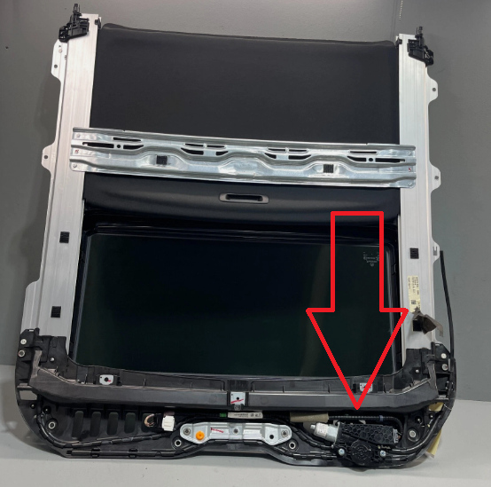

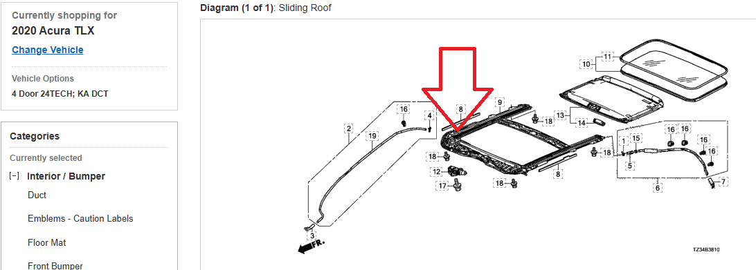

I'm not observing any Passenger side 'cable' on the OEM part diagrams below (red arrow).
If one is present, it is likely integrated into the #9 sunroof frame?
A new sunroof frame my be needed.
