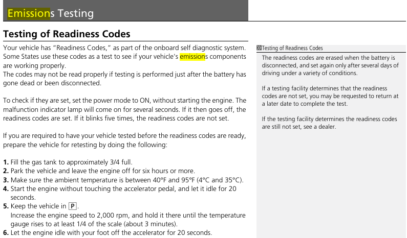

My 16 year son just bought a 2015 V6, unbeknownst to us, the shady private seller used a scan tool to cleared the codes just before we took delivery—was told by a mechanic when we went to do the emissions to get it registered, the emissions status reads "not ready" in about 4 catagories. My question is how long does it takes for the "check engine light" or any code to come back on, we've driven it for 150+ miles after delivery of the car. Constant highway 65-70 MPH too and city driving. So far no "check engine light"... but cannot pass emissions.

The owners manual states '...several days of driving under a variety of conditions.'
The below screen shots, from a 2015 TLX owners manual, lists a process that may help expedite 'readiness' if you want to try:
Owner's Manual & Warranty | Acura | Acura Owners Site
