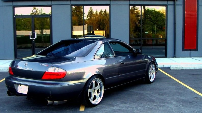

I have always run staggered setups on my cars because it LOOKS better. Personal preference but a deeper rear wheel is just more aesthetically pleasing to me. Especially with the TL, the rear form of the car deserves a slightly more concave or deep dished wheel. Again, personal preference.
And here is my CLS6 on staggered rims but 235/35 all around. Never an issue.
