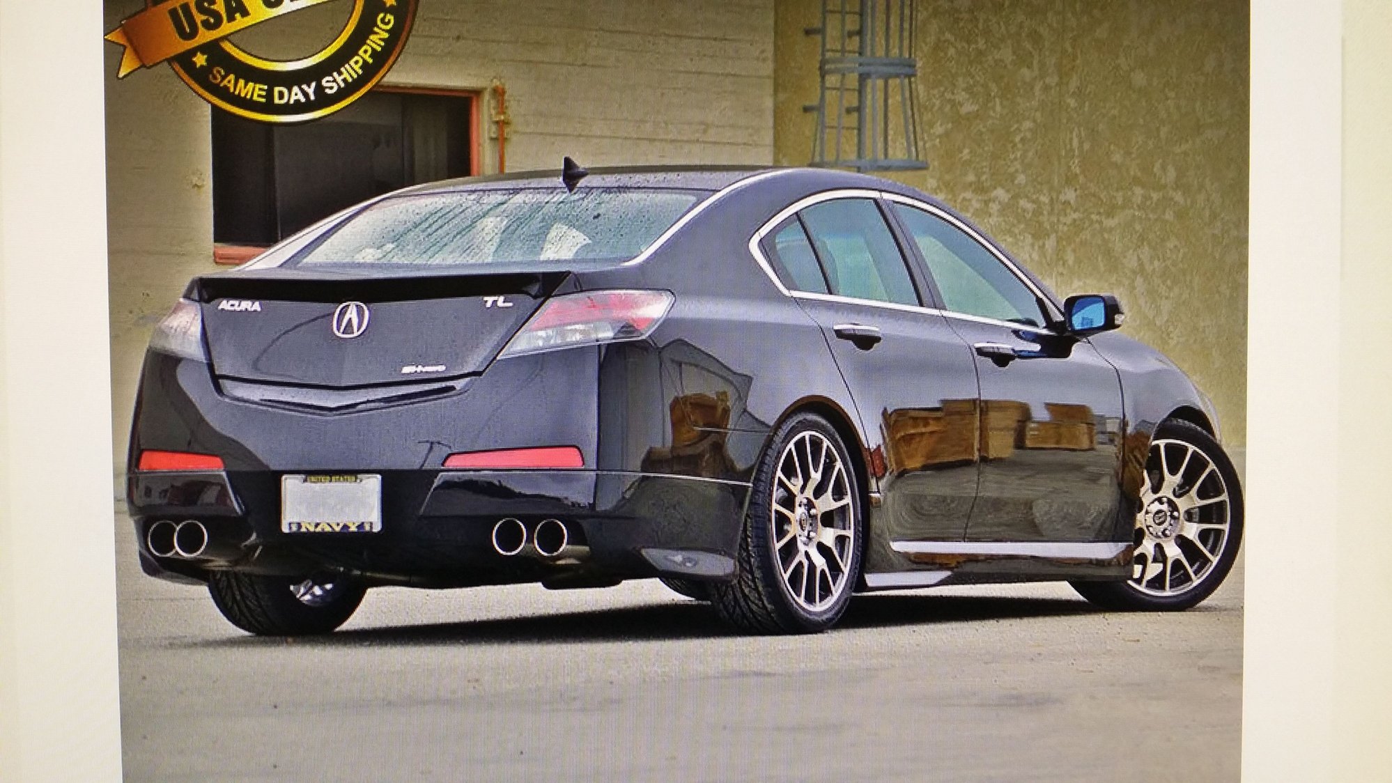

I'm not sure if these wheels are Canada only elite, but they're the 19s pictures below. I want to do h&r springs and some spacers on my car but i'd like to see how it looks, so if you have any sort of similar colour/trim/packaged combo with the springs and/or spacers I'd like to see. Also would take some suggestions on spacers to use and what thickness. Car is sh-awd.

That's the 'Advance' package wheels in the US.
I have H&R springs on mine with the Tech package 18's and I think it looks fantastic. I don't think you really need to see it.

I did some searching with the "advance" package wording and came up with the pics below - looks amazing.

Not the Elite wheels, however the link below is my car with 19" wheels when it was lowered on H&R Springs. You will also find pics showing the difference (measurements) of the ride height.
For spacers on the stock rims you will need 25 mm all the way around, some members also use 20 mm front and 25 mm rear.
Click on the link below for pics.
https://acurazine.com/forums/photogr...-832308/page7/

Thanks for the pics, that's perfect! looks like it dropped it 1.25" front and 1" in the back which is nice because you don't get that reverse rake you see with some springs.
As far as the spacers, 20 for the front/25 for the back, i assume? What are some of the better brands of wheel spacers? I feel like this is a part you can't cheap out on. Do you need to do extended studs or any different hardware?

My TL with my old HPTs although someone on Ebay is using my picture, as you can still see my Navy License plate frame on there
Another picture that is more recent, and still used my picture. Not sure where they're getting them as my brother took the pictures
