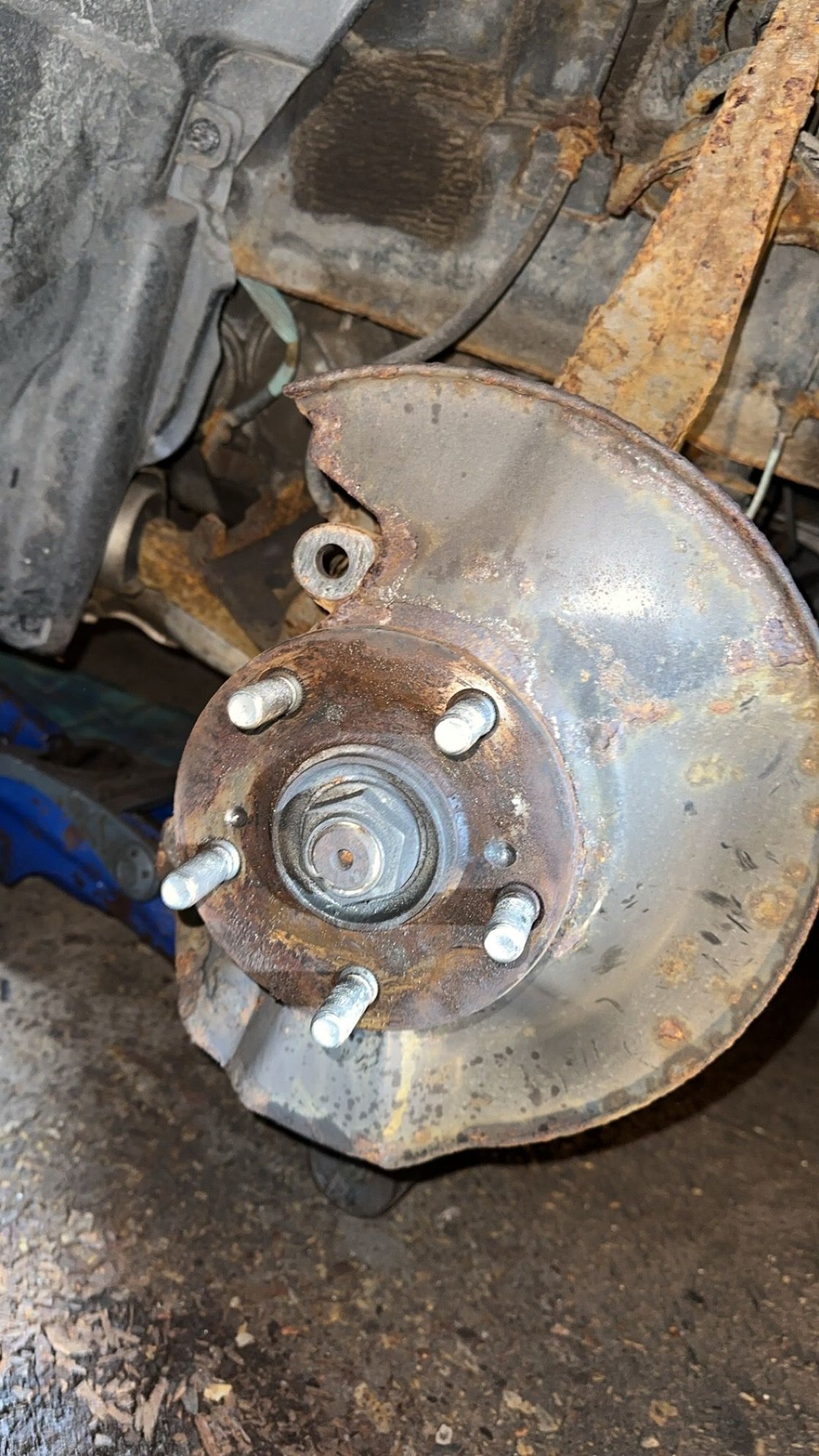

I think they were the original rotors on there. I took me and another guy 2 Saturdays to get em done neither of us or my 84 year old military mechanic have ever seen anything like it. we used a gas right below acetylene do get the retaining screws out, we had to bore 2 of them out on one rotor. The rotors were incredibly stuck i would have trusted that rust more than a weld. We tried a rust remover spray inside, hammers, acetylene, a sledgehammer, everything before we started grinding it in half> then ones grinded enough so if we hit it with a sledgehammer it would split, the bottom half of the rotor fell off from the hub part of the rotor then wedge a screwdriver up in between the rotor and hub and literally pried the rest of the rotor off in pieces. If I was on my phone I'd send pics it was messed up.

only took these two I guess but that was the first one we got off. Shit was messed up man.
when I bought it there was no rust either. I got it undercoated then it sat for like 10 months, now look at her I want to get rid of it all this summer, any recommendations?
