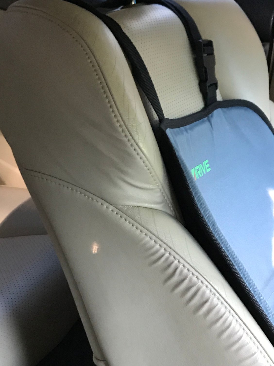

I have a 2012 TL SH-AWD and my front seat bolster is peeling! What is bizarre is it is not where you would think, it is in the arm bolster on the RIGHT side of the driver seat. the material actually may be vinyl, not leather, as usually just the seating surface is leather, but my question to the community is anyone else experiencing this? Have you gotten satisfaction at the dealer?
Pics attached
Thanks!

Why is it all puckered like that? That’s a defect in itself.

Well guys here’s my 2019 Acura TLX loaner. The seats are a much better quality than our 4G TL’s. They are more comfortable and the leather looks to be more durable.
