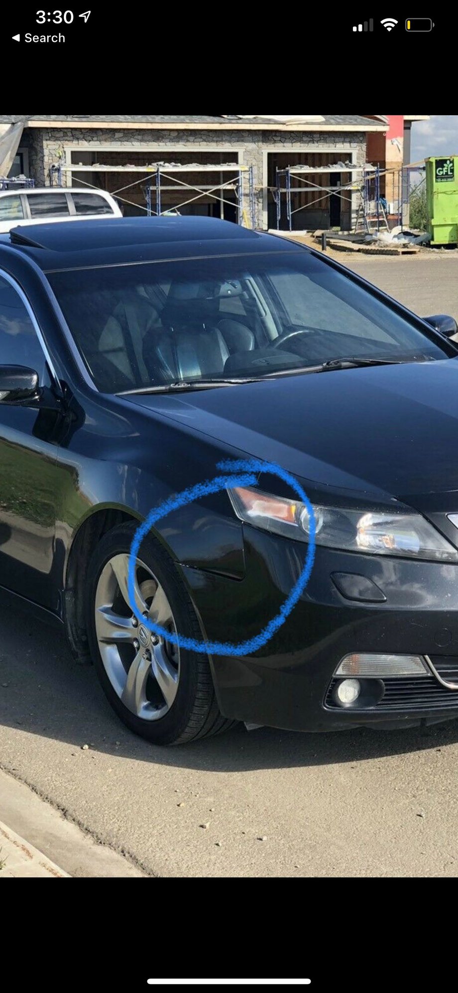

The front bumper of the TL (2012 SH-AWD) isn’t connected properly to the front quarter panel. The guy described it as there’s a few hooks or clips missing which should be an easy fix however I want to make sure.
Here is a picture of the front. On the other side it’s perfectly aligned however not on this side. If someone has information please let me know.
Thanks

I believe it part no 14 or 15 depending on the side:
https://www.acuraoemparts.com/v-2012...--front-bumper
use coupon code acurazine for 5% off. You can call them or email and see if its correct.

If the problem still exists just unclip the bumper and make sure it was aligned properly before putting it back on. A guy around my area had the same problem the clips on the black bumper piece that is attached to the headlight was off just a tad bit due to him putting one side of the bumper on first.
