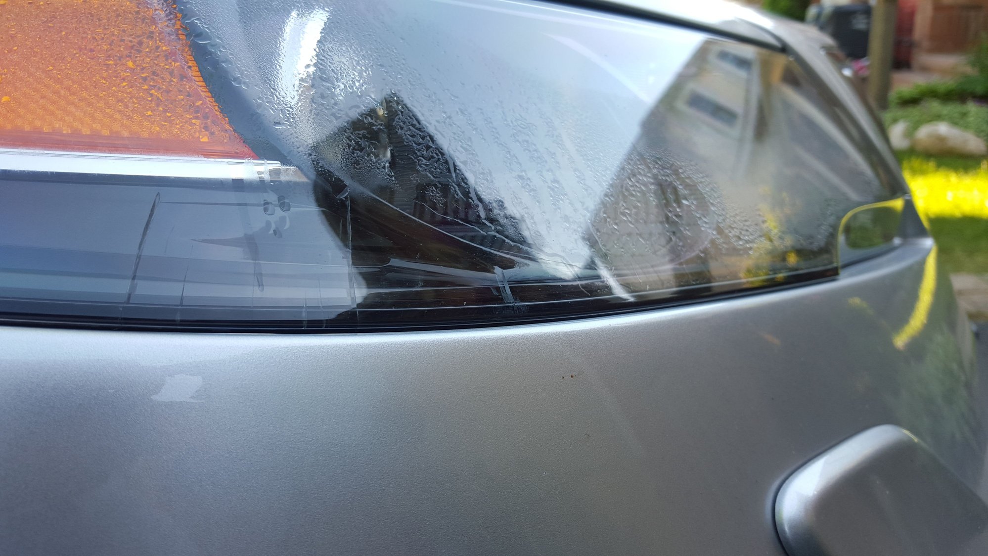

So cracks are appearing on my headlight housing on both sides. Noticed them a couple of months ago but it's getting longer on passenger side.
No impact damage or any other signs or marks of it.
I only drive to work and back and car hardly sees the major highways.
Dealership says its not a defect hence not warrantied and their sole reasoning is that they haven't seen anything like it before and assume it caused by impact/damage.
Needles to say, I'm not happy and don't want to spend almost 2k replacing both housings.
Has anyone else had this strange cracks originating from the bottom?

Wow!!! Was the car exposed to extreme heat or cold a few months back? I know in Canada a last few winter were very nasty. The extreme low temperatures don't help our cars at all. On the first two pictures, do I see condensation inside the housings because of the cracks? The light housings on Tl should be able to handle extreme colds and heats.

If there is crack in housing, there will be condensation.

Yeah it condensates now. First saw the cracks sometime in April and they were just starting. Now the passenger side is getting longer.

It's interesting/bizarre that the cracks seem to be perpendicular to the bottom edge of the lens. And the fact that it is both lenses. What year is your car - any possibility of a warranty claim?

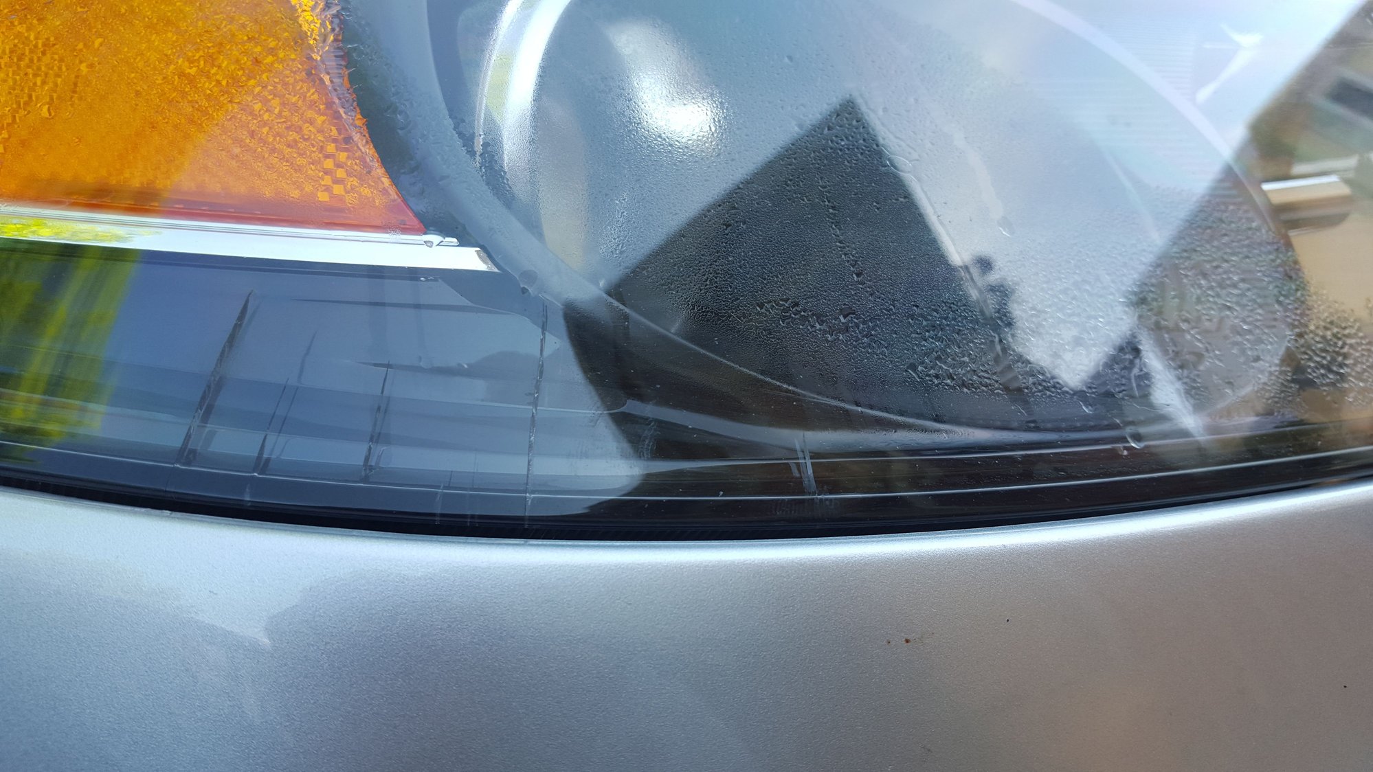

Seems so. Looks like it's trying to separate from the epoxy that is holding it together.

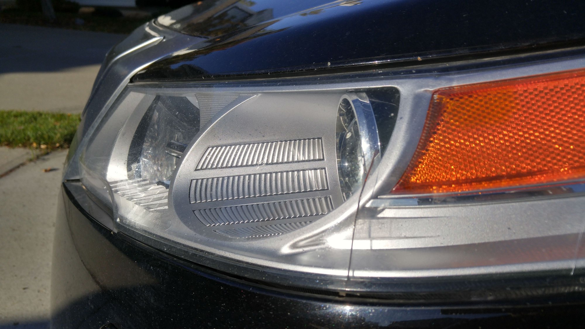

I have experienced the vertical stress cracks on both of my headlight housings. Unfortunately, I was past the warranty period. So, rather than pony up the ridiculous amount of money for two new housings, I purchased two damaged OEM housings on eBay, took the lenses off and swapped them onto my housings. I also used it as an opportunity to upgrade the projectors with TSX-R lenses. Still worked out much cheaper than new housings and the quality/appearance of the optics improved. FWIW, I'm also in Ontario.

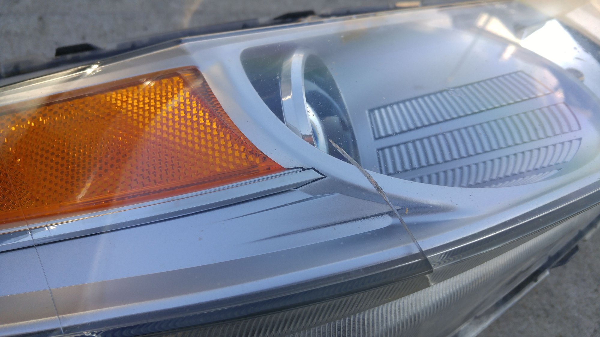

For what it's worth if someone else ends up with this issue or just interested if it happens to others...
I live in Alberta and I have the same issue. I have 3 long cracks on the passenger side with condensation inside the headlight housing and a tiny crack on the driver side with no condensation inside. Exact same spot, never been in any sort of accident or impact. I wonder if it's a stress point in the headlight housing.
I called a dealership and they said the warranty on something like this is 4 years/80,000 km whichever is first. Unfortunately I was out of warranty on the latter.
Dealership quoted me (Rounded) $950 a head light + $360 in labour or around $2,300 to fix. Currently chatting with my mechanic trying to figure out an alternative to replacing both headlight casings or a non-OEM product that might suffice (I really only care that I don't short out my electrical system). The above $2,000 is actually pretty close, and the pun added is correct as well.

It's a weak spot in the moulding that's for sure. I think our climate just accelerates the defect.

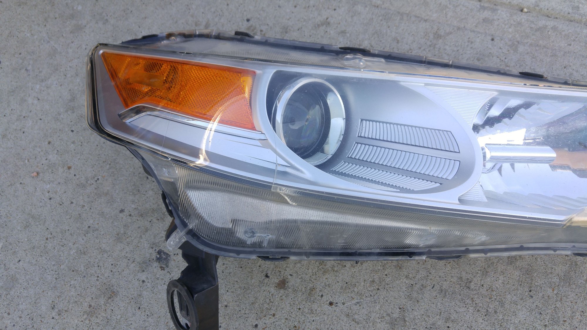

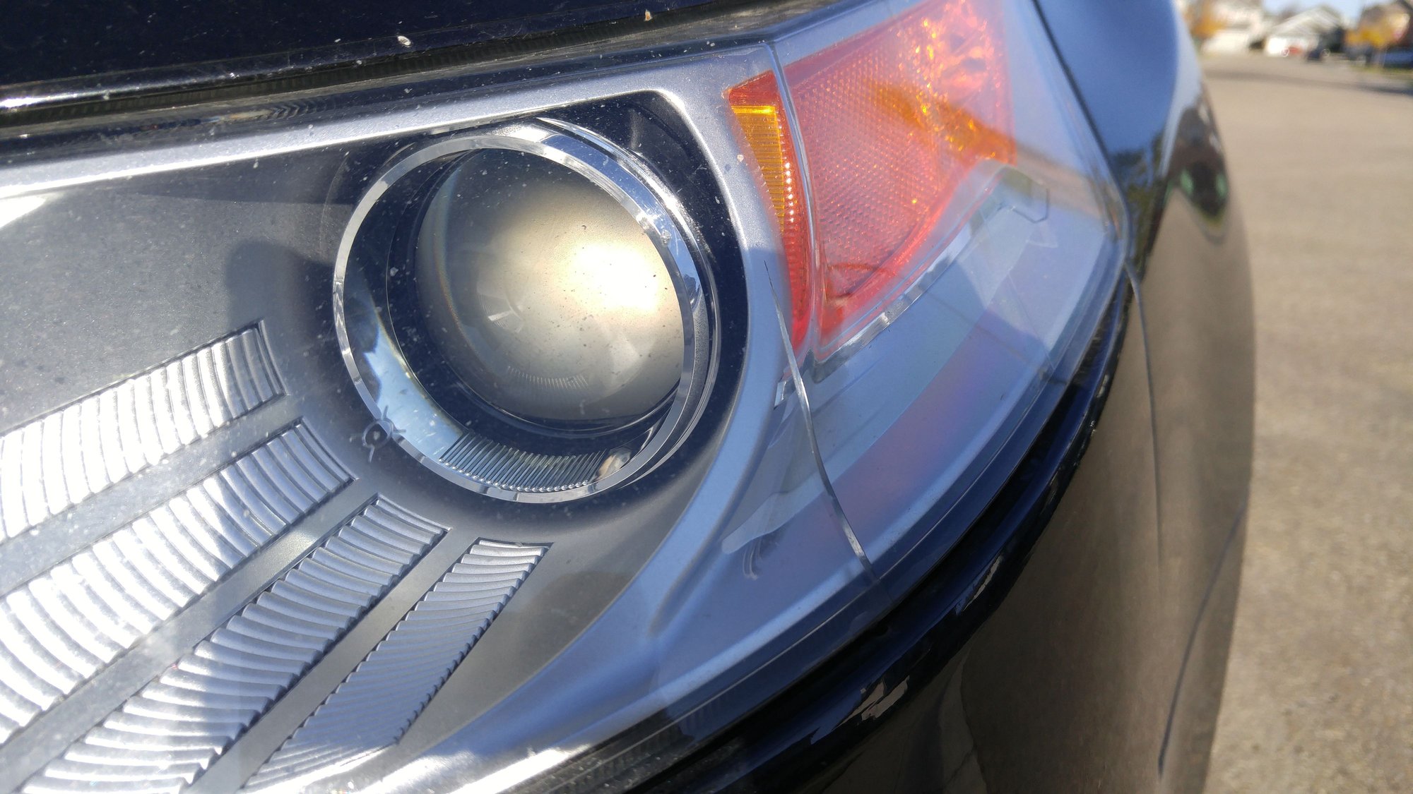

At the risk of reviving an old thread, I have further proof that this is a result of design and construction, not abuse.
I replaced a headlight with an OEM last year; passenger side. Had a visible crack, and got condensation (a lot). Ordered the headlight from AcuraOEMParts.com for about $540, with another $60 for shipping. Likely saved only a few dollars over buying local, once the FX is factored. Stupidly, it was important for me to go OEM.
I've since developed a crack on the driver side. My mechanic is pushing me to go aftermarket, but I've had this notion that the OEM are better parts. That changed today. I was cleaning out the garage, and took a look at my old headlight that was changed out a year ago...trying to decide what to do with the thing. I compared the crack in the old headlight, to the newly cracked headlight, and it's pretty clear the cracks are close to identical, with no signs of impact. I've attached images taken with my phone.
Newly cracked
Previously replaced
Based on this, I've lost my aversion to the idea of aftermarket housings. They may indeed not be better that OEM, but I doubt they're worse. And for the price difference, I would expect the OEM to last. In my experience, they don't.

I got some cracks too, not sure if self-inflicted or heat/cold extremes. One way or another I have found replacement ranging from $269.20CDN (amazon) to $742.42CDN (local dealer). Not sure if the amazon ones are new or used, toss a coin!! So, I am thinking of the aftermarket...
PS. no chance of warranty work for me, I am waaaay beyond any limits LOL. But the truth of the matter is on the '09 they installed total crap material there.
