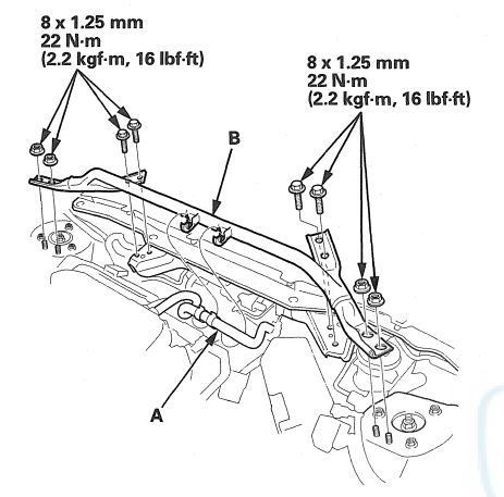

4th gen Strut Bar torque spec
Can I please get the torque specs for Strut Bar. It has two connection point in engine bay: fire wall and wheel well.
thanks

Old Aug 20, 2019 | 01:15 PM
JC9898's Avatar
3rd Gear
Joined: Aug 2019
Posts: 3
Exactly what I was looking for! thanks a million for the quick response, much appreciated!!!!
Is there online documentation I can refer to for future torque specs for any and all 4th gen TL repairs?
I can find lots of 3rd gen specs online but not 4th gen.
Thanks
