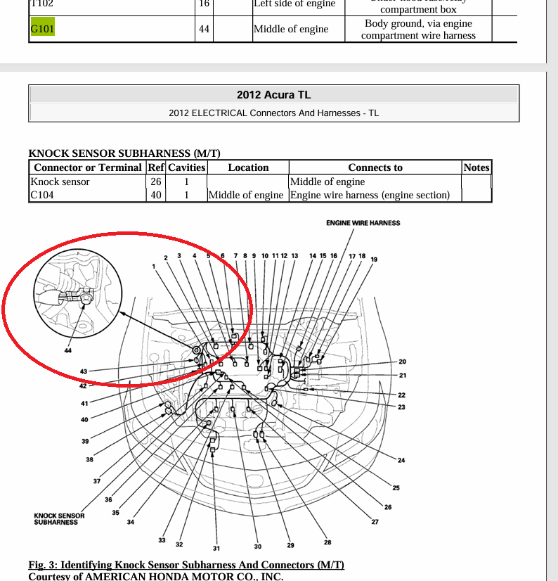

I'm no expert when it comes to this stuff but I've done a motor swap for a C5 corvette before.
Maybe double check the grounds?
"For the 2012-2013 Acura TL 3.7L (J37A4), the crankshaft position sensor (CKP) grounds through ground point G101, which is shared by:
  • CKP sensor
  • CMP sensor
  • ECM/PCM
  • Ignition coils
  • EGR valve
  • Various solenoids
G101 is located on the engine and functions as the primary engine ground for these components, including your crankshaft position sensor circuit"
