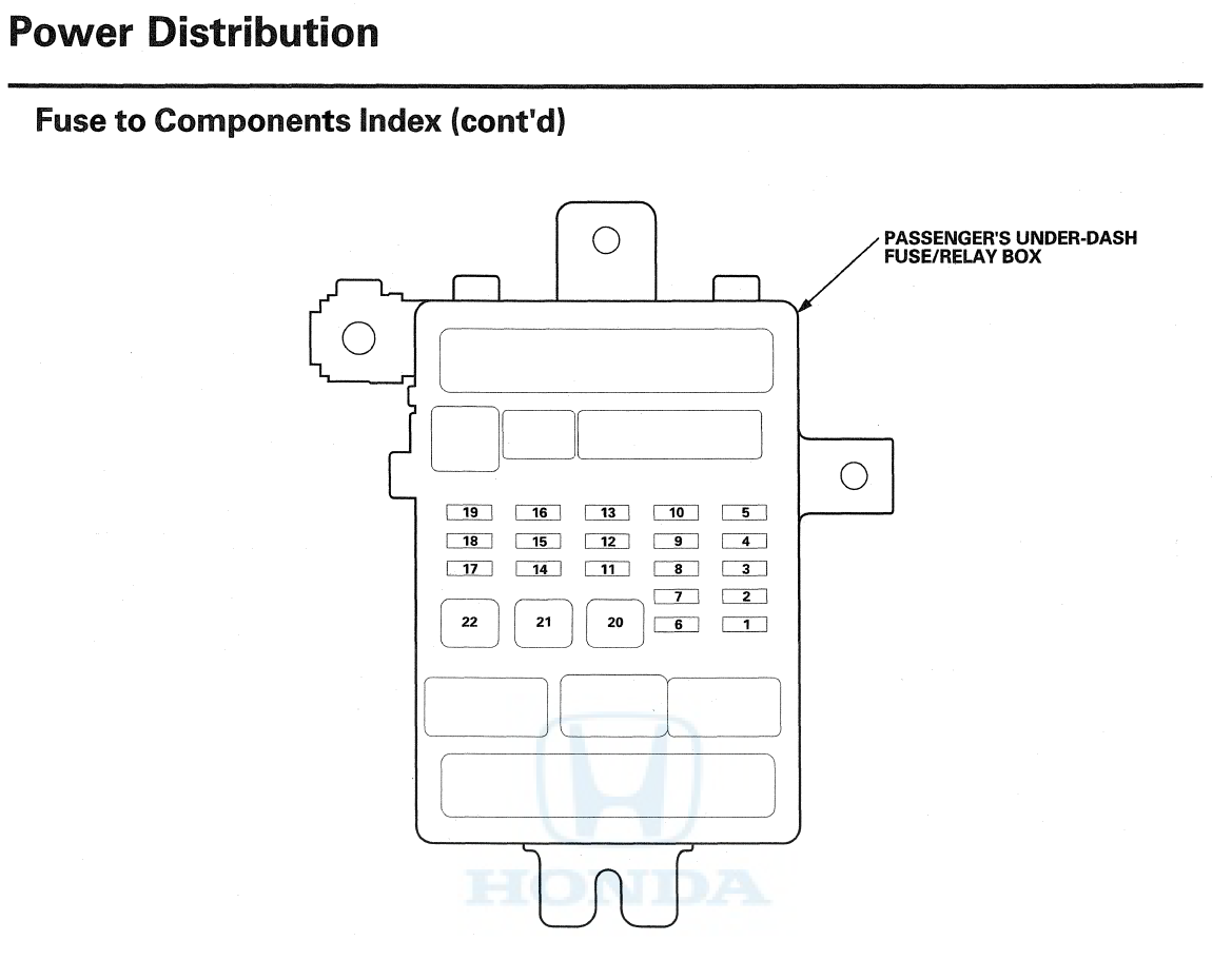

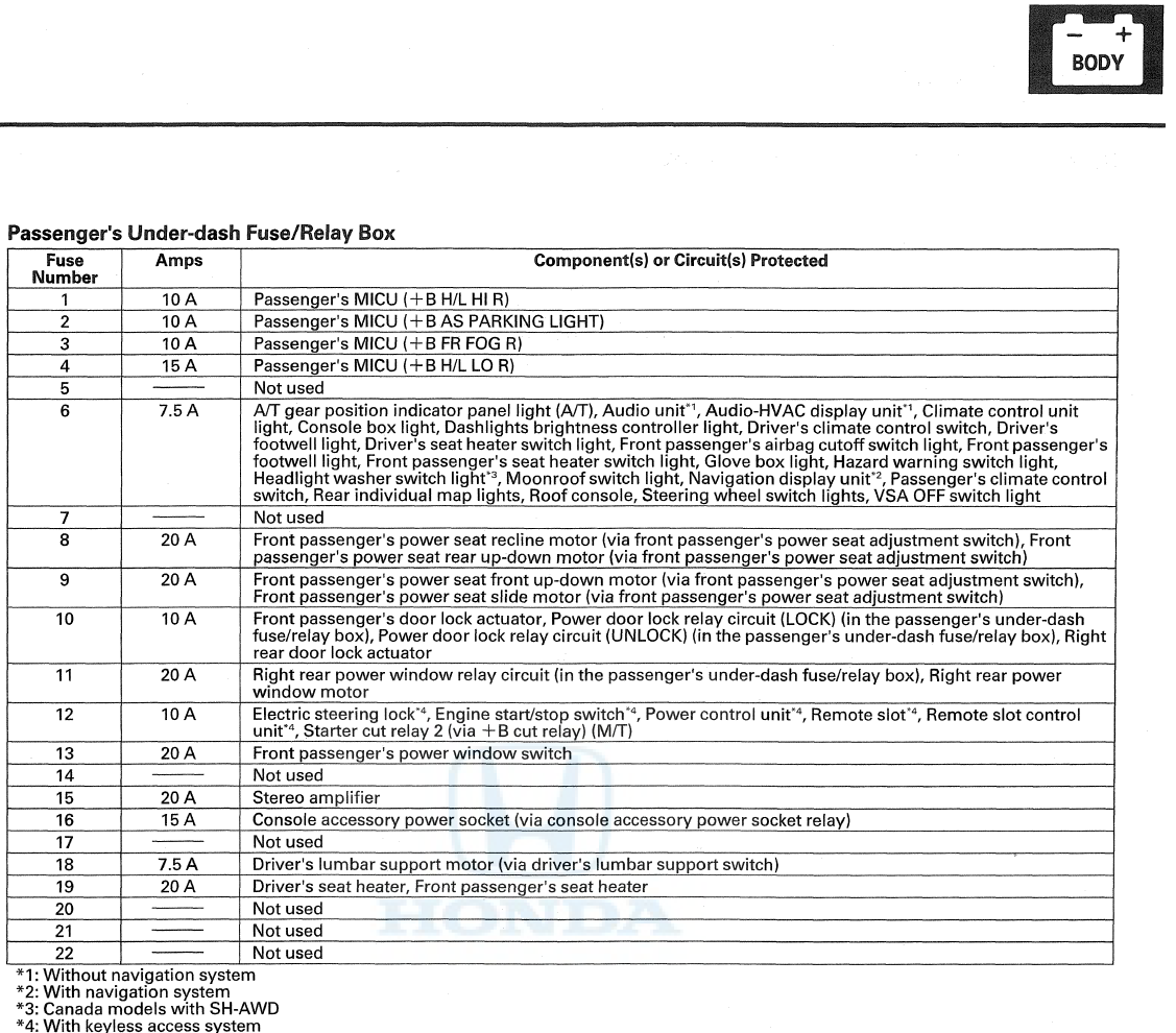

Yeah, check fuse 18 under the passenger's side of the dash. That's the fuse for the lumbar support motor.

Thx. I pulled fuse 18 for the lumbar support (7.5 amp) and it looks clean. After reseating the fuse, still no noise or movement. I guess it's a lost cause at this point as it isn't worth the time or money to have someone look into it further.

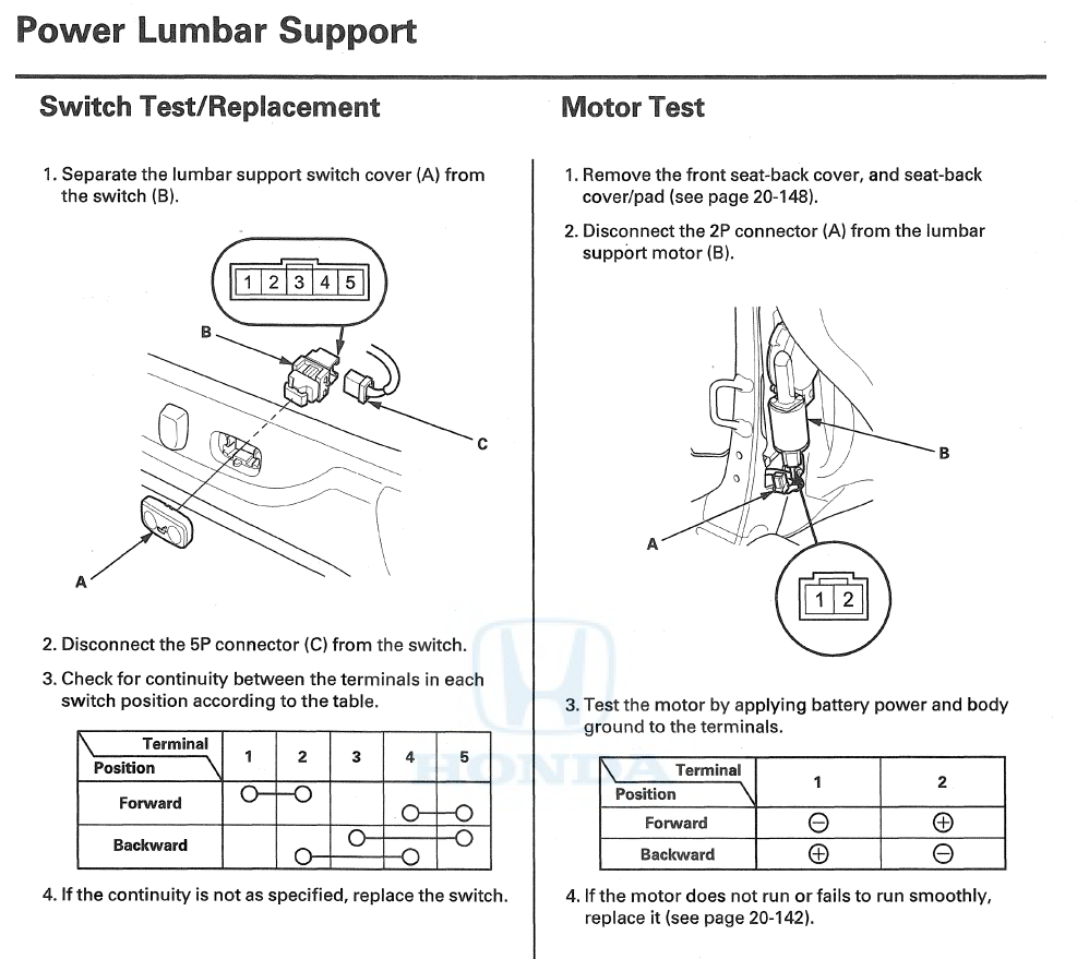

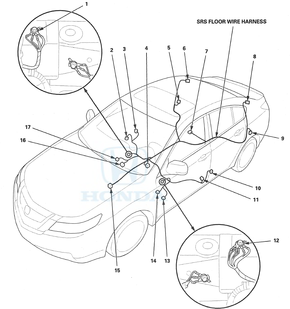

The other thing you could check is make sure the ground is still attached. The grounding lug G701 is under the driver's seat (reference #12), see if there is either corrosion or a disconnected wire.
If you wanted to dive a bit deeper, you could pop out the switch from the side of the seat and see if it's bad. Luckily this is a simple circuit and doesn't involve any computer controls. Just power to a motor, a switch to control it, and a ground. Worst case would be a bad motor, and that'd involve pulling the seat covers off to get access to even test it.
