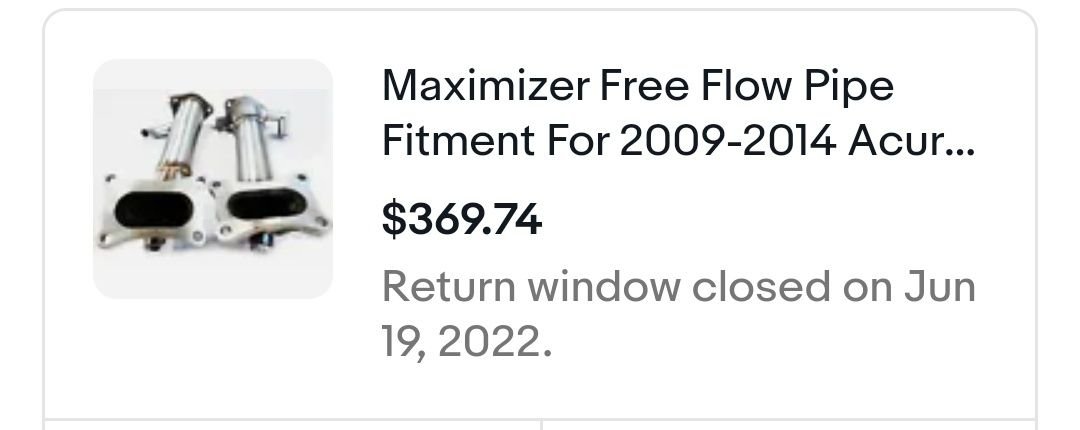

Got lucky on ebay and found some from this company called Maximizer, the vendor disappeared soon after I bought em though. They're not as nice looking as the usual competitors but they're very similar in dimensions and I definitely felt a power increase after installing them as well.
I did look again and found some on Walmart of all places lol so if you're interested there's that option.
https://www.walmart.com/ip/Maximizer...-7L/2223565017

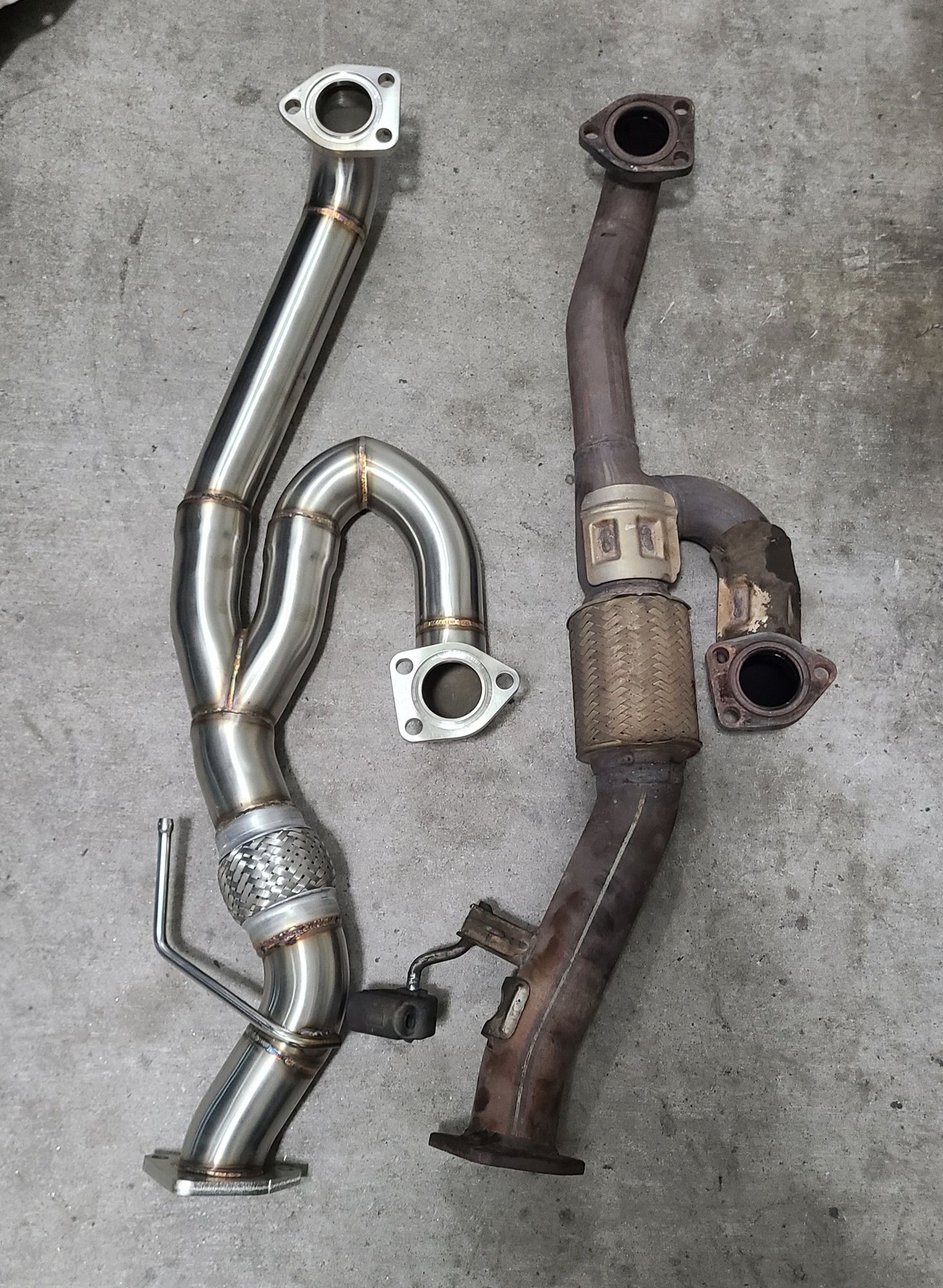

So, I dont have a 4G Tl... But, I did recently install an 4G TL OBX fwd j pipe and pcds on a 8th gen accord v6. With pcds it does vibrate the car a bit. But, other than that seems okay. The j pipe will bolt to stock pre cats and retains the stock 3rd cat (which is what I wanted).
obx j pipe vs 8th gen accord j pipe
On a related note noticed an increase in suction noise from what sounds like the CAI after installing. Any one experience something similar?
