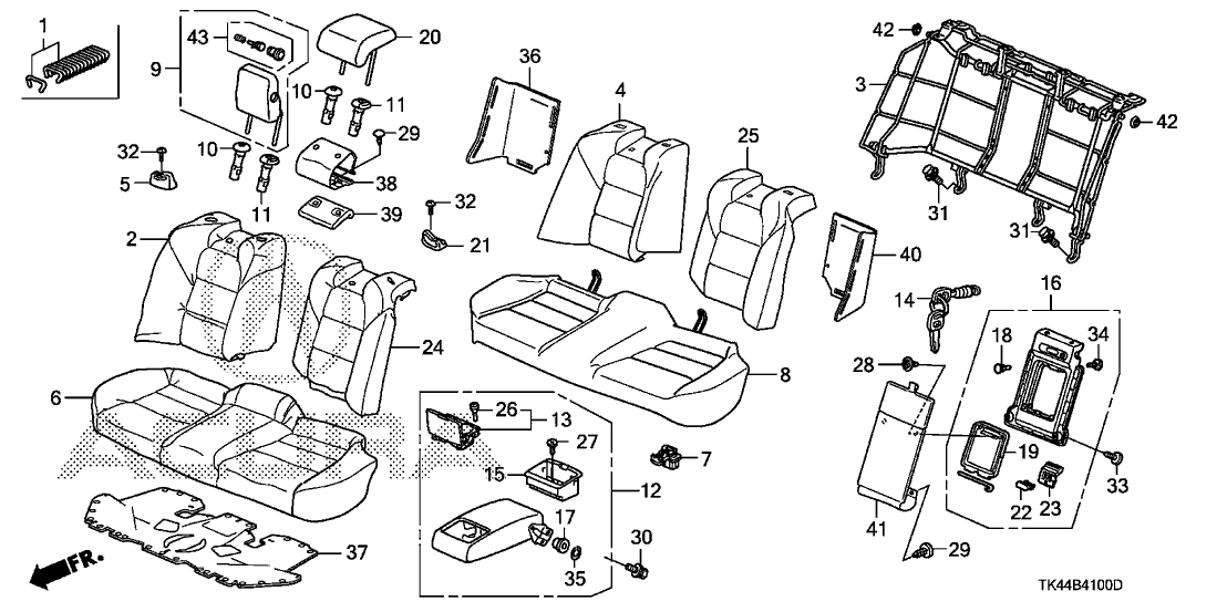

on the middle of each seat cushion (left and right) is a clip that needs to be released. You PRESS DOWN on the CUSHION, and from under the seat you pull the tab forwards towards the front of the car to release it.
It's part no-7 in this pic:
and it looks like this (this is the same one from the 3G TL) Look at B-Hook 2:
