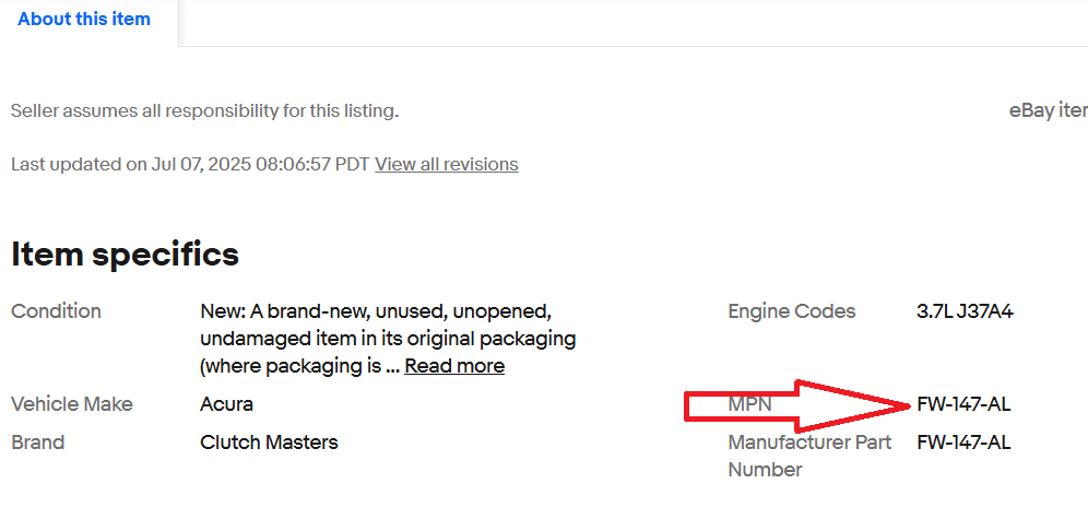

Be careful with that website. When I clicked the 'Options Available' page listing $674.25 as the price for the FW-147-AL
It suddenly increased to $799.25.
Here's one on ebay for $616.25 with free shipping:
Clutch Masters Aluminum Flywheel For Acura TL SH-AWD 2009-2014 3.7L J37A4 | eBay
