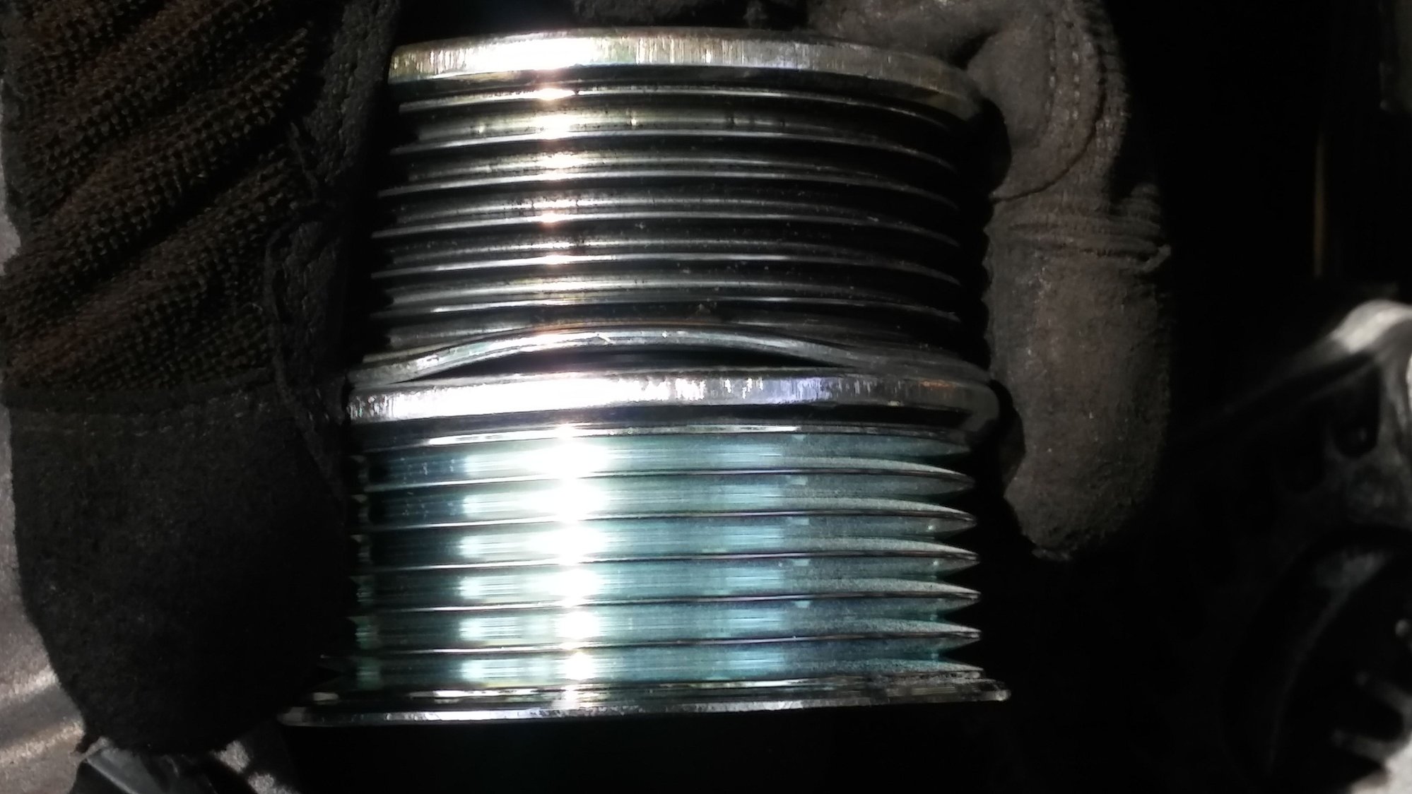

Hello, im fairly new user, i prowl around reading everyone post learning about my 4g TL sh-awd. but i recently noticed a fairly alarming issue.
i purchased this car a 2010 4g about a month ago, all seemed well until a buddy of mine noticed that the serpentine belt had a small nick in it. wasn't to much of a big deal at the time said replacing it would be a walk in the park. fast forward 2 weeks we were about to replace the belt when we noticed the cause of the nick of the belt. it was the alternator Pulley. the edge which secures the belt in place was slightly folded inward. which i would assuming might be nicking at the belt causing it to get dmged.
so now im sitting here trying to figure out what my next move should be. i need to replace that belt before it snaps but that is only a temporary fix since the alternator pulley will eventually eat through that belt as well. so my only other choice is to Replace the alternator all together or just replace the pulley on the alternator.
has any one here attempted to remove there alternator from there 4g? possibly can give some tips i rather save the 70-90 bucks that a garage might charge me to take it out. also is there a designated name for that pulley kinda want to search the net to see if i could purchase a replacement.

So tonight with help of a buddy of mine, re took out the alternator and replaced the pulley. here are the attached photo of before the replacement and the after pulley i was inserting. the belt was so messed up. from what i could tell i think who ever messed with the alternator before might of dropped it on the pulley and it bent. the repair shop probably covered it up and didnt say anything, any ways thanks for the help guys

Damn thats like messed up.
I do have slight bit of worry that the bearings in the alternator have been put under uneven stress for a while. However if cost is a factor do what works for you.
Old Jun 5, 2016 | 11:03 PM
blingcasper's Avatar
Joined: May 2016
Posts: 15
well the alternator at the moment makes no sound what so ever (did not make a sound before). its giving me 14.01 with the multi meter, and besides the pulley was the only notable dmg it had. but you are right in that regard and i am worried that w.e made that dmg might of dmged something else. for now i went with the cheaper cost and will keep and eye on it on a week to week basis to see if getting a new alternator might be in order
