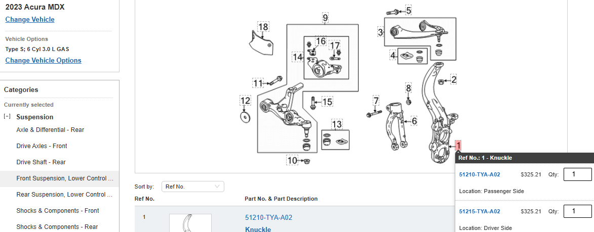

The below displays the part number for the left front knuckle of the 22 MDX ASPEC, to which the left front brake caliper bolts onto:
What does the 22 MDX ASPEC front left knuckle part number above have in common with the 23 MDX Type-S left front knuckle below?

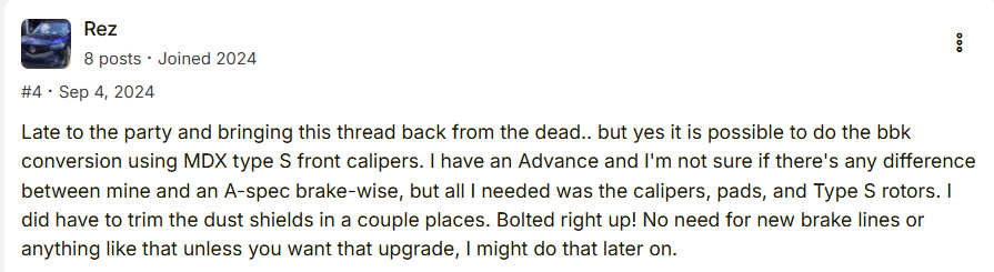

Here is a guy from another MDX forum who states it is doable:
