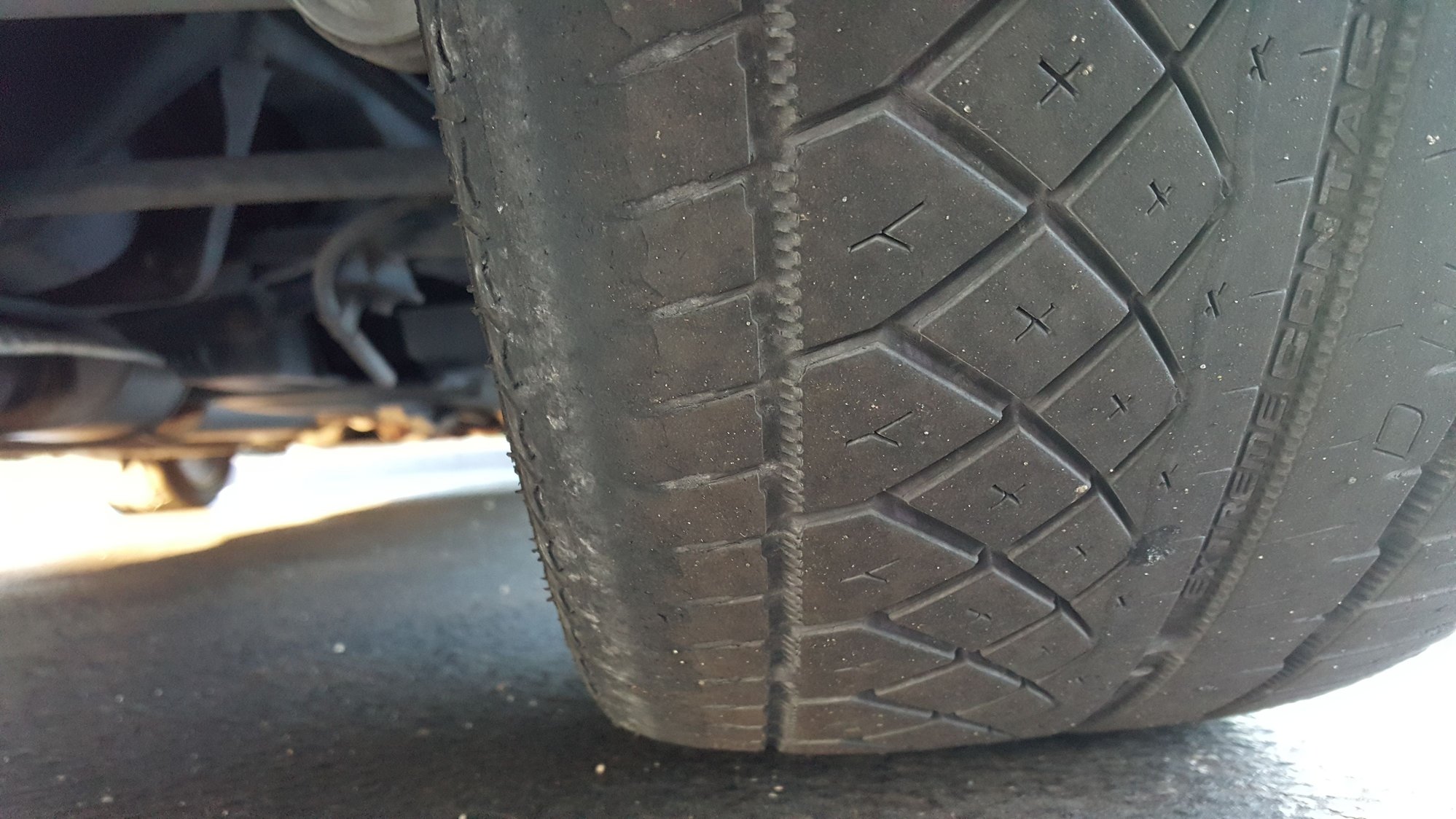

This is the middle of the story but I thought I'd start off here. As you can see the tire wear on the inside is almost down to the bands. I purchased 4 continental extremecontact dws 06's in August of 2014. This picture was taken roughly 25000 miles after that purchase.
This all started when I brought my car into the dealer on Saturday for a B1 service (oil change and tire rotation). It was also due for transmission fluid and power steering fluid. I get my car serviced at the dealer because I've been treated very well all up until this experience. After about 2 hours the service rep comes back and tells me nothing is wrong with the car and it is going through the wash. 2 minutes later he comes back and says he "forgot" to mention the tire wear he noticed and that my rears were down to 2/32" and my fronts which were just rotated on were down to 3/32". He then states and shows me on the rears from the pic above where the metal bands could be seen.
I leave the dealer since I did not purchase the tires through them and call up Dobbs ( local tire and automotive place) and explain to them what has happened and that my tires should be in warranty for tread wear. I am nervous to drive the car with the tires in this condition so I tell them I am bringing all of my service history with me to see if I can get a set of replacements.
I drive up there and the service manager puts the car on the alignment lift and states that the alignment of the car is out and because of that I can't go through the warranty process. Now, I have driven a lot recently since I took a new job and moved which basically means I have a 2 hour round trip commute 3 days a week (85 miles total those 3 days). The tires were checked in July for my last oil change and we're at 7/32" in the front and 8/32" in the rear and had been rotated once in March.
Now if the alignment were off I feel like I would have noticed this since I am literally in the car for 6 hours a week minimum on the highway. I had no pull in the steering during this time and no vibrations.
So with no recourse I need new tires for the car. Dobbs location didn't have the Continental's so I went with some Pirelli P7 a/s plus. Service manager gave me those at his cost which end up being $100 cheaper than what I originally paid for the Conti's. He recommends I get the alignment checked every time the tires get rotated.
After spending $770 for an alignment and new tires I am pissed and I feel like I am being taken to the cleaners.
The solution?
A friend recommends I go to Firestone and I can get lifetime alignments front and rear. When I do that I'll probably go ahead and get it checked each service interval from now on.
The warning? I guess just be more aware of what is going on with your car and be vigilant with checking your tires out. I'll probably visually inspect my tires each time I get gas now to see if there is any weird wear patterns.
Thanks for reading. Any other advice let me know.

It's normal for your alignment to eventually go out and it is considered a maintenance item. What did Acura do that was wrong? What did anyone do wrong, besides you not keeping up on the maintenance of your own car?
Checking your tires every fill up is a bit of overkill. It's a good idea to take your car in for an alignment, at a minimum, once a year.

Suspension wear, or even a faulty alignment will kill the tires, but when the tires are rotated the "mechanic" should note any unusual tire wear noticed.
Post the current alignment printout just to be certain the job was done properly and future problems might be eliminated.

I have had good success with firestone's lifetime alignment. these cars will eat up tires with a bad alignment and if you drive hard and are lowered, its a big heavy sedan.

It's a lifetime alignment so just go every 5K miles, or 10K...
25K miles out of a set of tires seems like a dream. I haven't gotten more than 12K out of any set in a long time.
I will tell you this about the TL...it toes out very quickly with any weight added to the car. Over the years I've chased this issue but there's no real solution...I guess one thing I haven't done is get an alignment with me in the car. The extra 230 pounds plus a full tank of gas will likely affect the alignment.
Plus, just looking at the wear you can tell it wasn't normal tread warranty wear. That is TOE OUT...no doubt, I've seen it on mine every time. So...aligned perfectly on the rack...get in and immediately the extra weight makes it squat and toe out. Then drive 25K miles and bam...there you go. I will say, be leery of lifetime alignments because we usual, once they have their money...quality...yada yada...
Lower away, man...you're already dealing with the tire wear issue, you might as well make it worth your while!

OP, pretty sure the wear is due to rear alignment issues. Post your before/after alignment sheet.
You might want to consider getting the SPC upper arms (~$155 shipped) which will keep the rear camber in spec whether stock or slammed...

that's not camber were...it would be spread a lot more evenly across the tire. That's toe, for sure. But I'm serious about getting it all pretty on paper and still having tires looking like that every single time...I need to align with my fatass in the car.
Out of spec camber exacerbates out of spec toe wear... I won't be the least bit surprised if his rear camber is out of spec or right at the negative limit...

That pictured tire has at least 4/32nd's of tread left. The wear bars are the federal min of 2/32nds and yours are almost double.
2nd, it looks like your rear shocks and front compliance bushings are bad. You do have camber wear caused by some negative camber, but you also have inner wear from bad suspension components. If you look on the edges of the tread blocks, you can see the zig-zag line from where the tire is oscillating out of the way it's supposed to be.
You could have had kept running the tires without an issue as long as you got the car realigned. Now that you have the new tires, invest in new shocks and front compliance bushings.
Firestone does lifetime alignments for around $150.

OP you might want to look into a camber/toe kit to get the alignment perfectly within spec. We offer the SPC rear camber arms for $78.18 per side.

I suggest to you OP, to ensure your tires are actually being rotated, mark them with chalk, crayon, or sharpie beforehand.
If those were aligned three times within that 25,000 miles of ownership, no way it'd had been that bad.
An "inspection" sheet with markings on it mean squat. Great, you let me know my perfect battery is perfect, and my new wipers are good. Really??? Who actually looks at these and and says to themselves "Gee, thanks for that inspection Bob!"
I usually tell them NOT to touch my fluids in the past when taking the car for a quick rotation or oil change. Dumb-asses watering down my Rain-X washer fluid with their crap.

OP, post a copy of your latest alignment sheet...
Before I get blasted for that...
If those were rotated three times within that 25,000 miles of ownership, no way it'd had been that bad.

Good luck with lifetime alignments at Firestone. Been there, done that and will never go back to those types of shops for an alignment.
