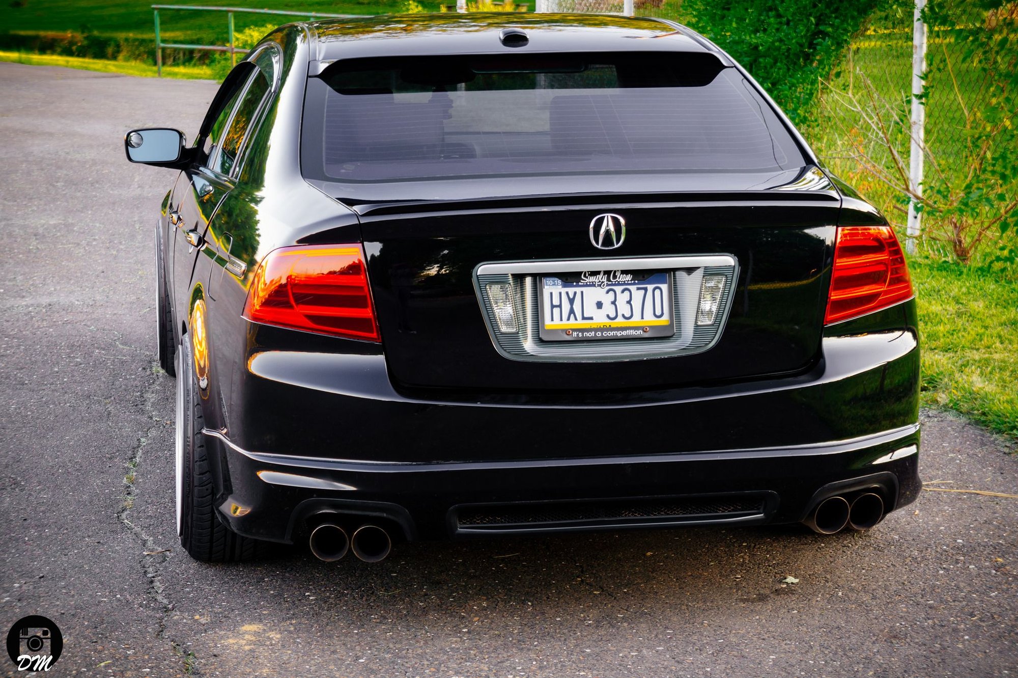

I run 18 x 9.5 +40 because I want to roll on big tires. Currently 255's, 265's soon with a slight rear roll.
BC3
by Andrew Thompson, on Flickr
