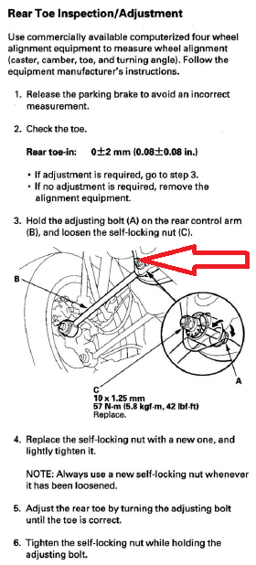

2. Did I break loose the wrong bolt? From the rear of the vehicle looking to the front it was the rearmost bolt that attached the rear bar from the chassis to the control arm.

However, the easy answer, regarding the breaking loose of the 'seized rear bolts' (first red arrow?) can be determined by looking at the FSM diagrams below?

The diagram you attached was helpful. It's dark, cold, and late here. I'll give the rear a look tomorrow if/when I get a chance.

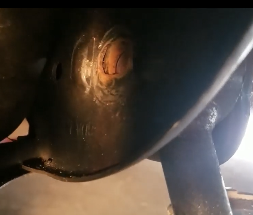

Well, I owe someone an apology. Thankfully all my accusations and angry thoughts were not voiced to him or the company. That thing is absolutely seized. I mean, I might could get it done with a shop load of equipment, but I'll likely cut it out and replace the bolt. I don't want to get too far into it until I have the replacement bolt in hand. I'll update my experiences as they evolve.

I had to replace a rear toe adjustment bolt. It was rusted. Get a reciprocating saw and a Diablo blade for metal. Don't use a SKILL Brand blade. They wont cut well.

I bought a new ARM. I twisted off or sawed the Nut side of the bolt but wasnt enough to remove the arm or the rest of the bolt.. I could jiggle it.. but I had to cut the arm on the HEAD side.. Which is facing the rear of the car.
See the Slit on the right side

Nut side with nut removed. Still too rusty to remove So I cut the other side as seen above
