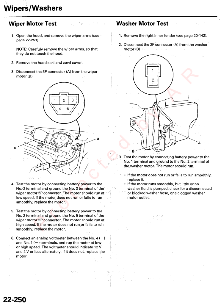

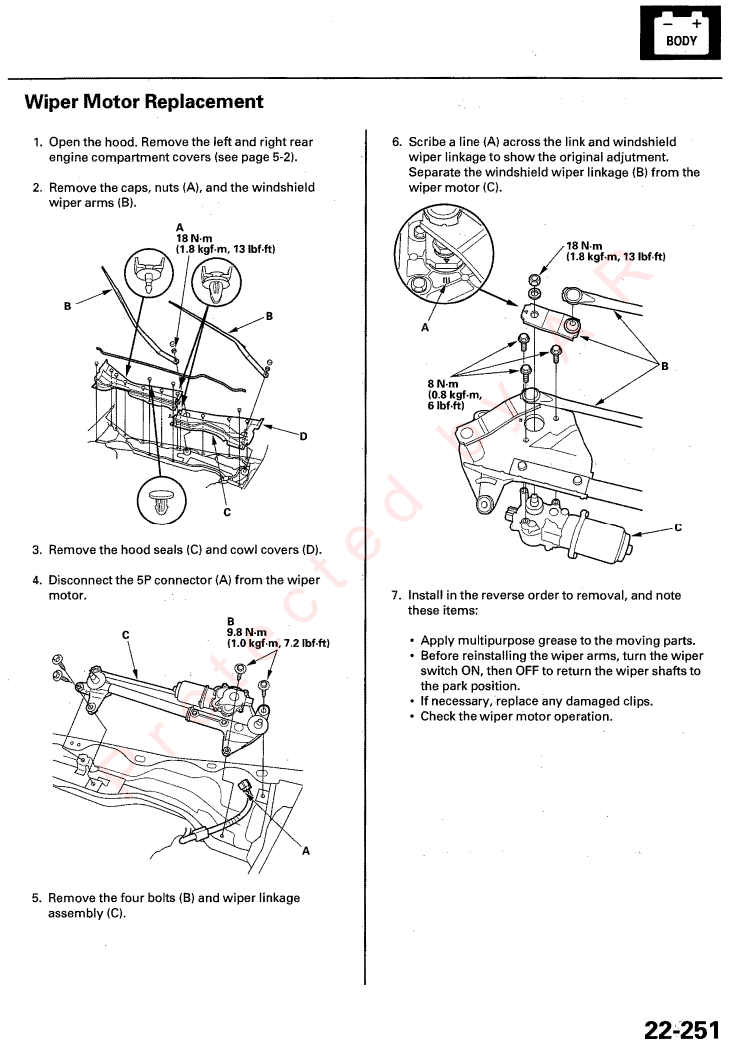

Did your TL get the wiper motor recall work done?
IIRC, there was an issue with water collecting and corroding the wiring to the motor.
The wiper motor recall came out about the same time as the power steering hose feed and O-ring recall (@2007-2008), so most owners brought the car in for both recalls.
If the recall work wasn't performed, you should get it done now, and it'll be free.
