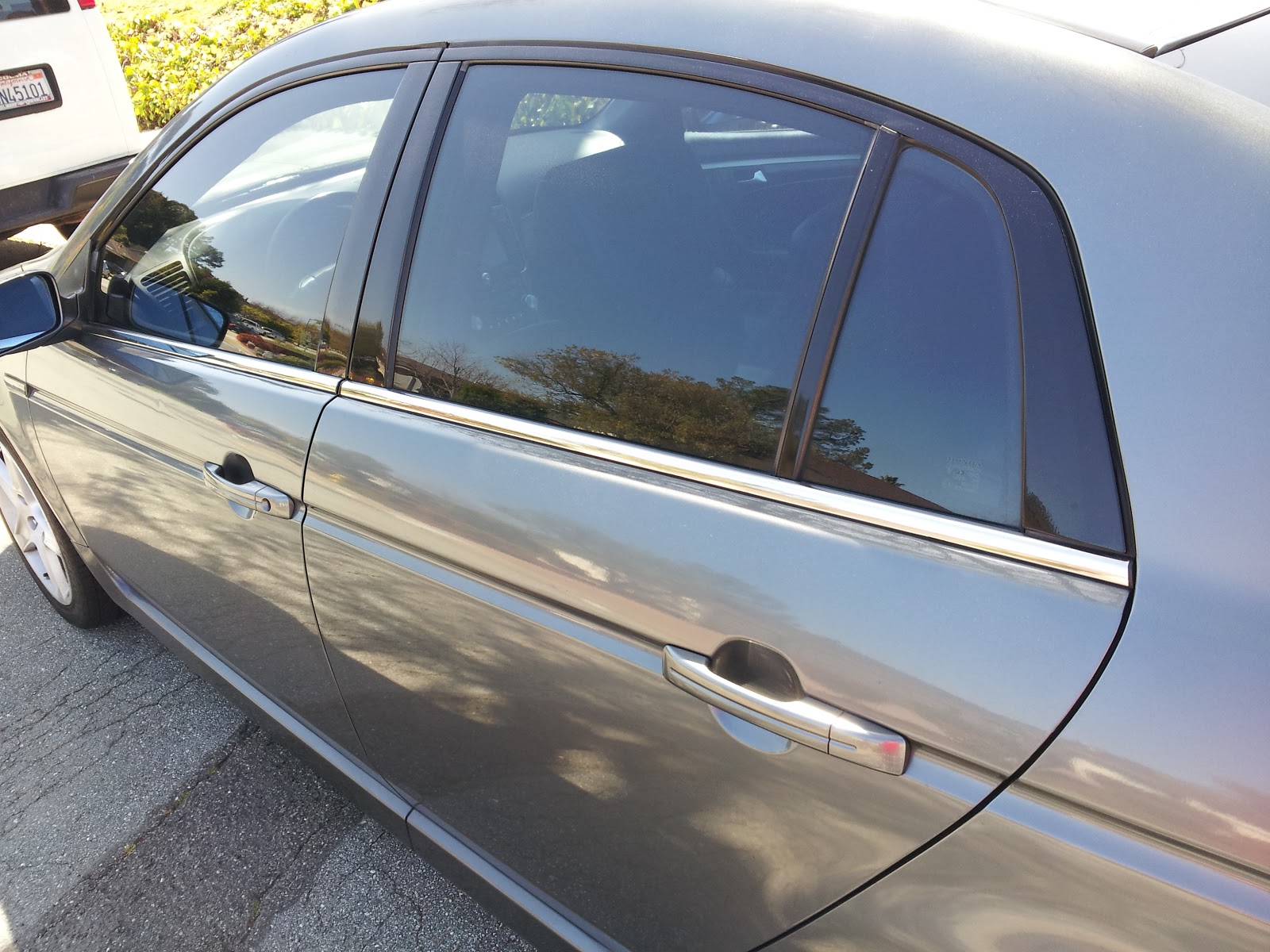

I just decided to blowdry them and peel them off. It comes off pretty easily, but the sticky residue that might remain.....WD-40.

Old Mar 16, 2013 | 10:29 PM

i just peeled the black part off cuz it was cracking. its chrome underneath.
