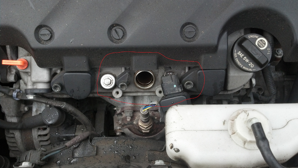

What the hell happened?
I was driving to work and all of a sudden my car sounded like a go kart engine. Doesn't look good, and it looks expensive. It is a '06 Tl with only 65k miles. I just got an oil change 2 days ago as well.

Did you check the oil level? Only reason I ask is because you said you just got an oil change so that would be the first place I'd check.

I had a xpress lube do the oil with Royal Purple, but look at the pic circled something blew out right there.

Sorry, I didnt see the pic the first time. Looks like you blew a spark plug somehow. Did you just change them? Maybe it came loose?? I have seen this on happen on another thread a while back.

first issue...the quick lube place

No, I didn't change out the plugs. No car maintenance has been done on the car except oil changes etc in the last year. The car has only 65,000 miles and is a '06. Just trying to figure out if the people over at the xpress lube did something that would of caused that or how that would happen.

https://acurazine.com/forums/3g-tl-problems-fixes-114/blown-out-spark-plug-twice-need-new-head-839160/
Seems to be an issue on '06 acura tl with manual transmission...hmmmm

Well from the sounds of it you MIGHT be in ok shape. I haven't seen it happen to a TL, but a friend blew out a spark plug in his vehicle and it made the car sounds like a lawn mower (just like you described). So if that's the case you might only have to put in a new spark plug and your good to go. Well now that I look at the picture again your gonna need another coil, but those are easy to find and shouldn't be too expensive.
So my vote goes to buying a new spark plug and coil and you should be all set.

i don't think it has anything to do with a specific MY. there is a larger thread about the spark plugs ejecting themselves. perhaps you are one of the unlucky ones with a loose spark plug. could be coincidence with the quick lube place or they went nosing around your engine bay.
the fix isn't going to be cheap.

Hopefully, based on the post with the link I provided ($225.0 for the repair ( new coil, heli-coil, plug )

The spark plug blew out. Did you have a ticking sound prior? If all the place did was an oil change this is just coincidence (for once). You can only hope the threads in the head weren't damaged. If you're lucky you might get away with just a new plug and coil. If you're not lucky you're looking at head repair/replacement. Personally I would helicoil the threads if possible. Have the plugs ever been replaced?
For now, take a look at the threads as best you can. If they look decent screw a new plug in and see if you can tighten it snugly. You may want to check the tightness of all plugs as well.

Yes, the car started making a ticking sound last week. I was going to have a friend check out the ticking noise on tuesday who works as a mechanic across town. But, I guess it is too late for that.

It definitely launched your spark plug out of the engine. I can't imagine how that would be possible without damaging the threads in the head. Your mechanic will probably need to re-thread that.

Mechanic just called...he wants a $1,000. Repairs - helicoil because it stripped, all new new plugs, new coil, he said the valve cover needs to be replaced so that they can re-thread it with the helicoil kit. That part sounded fishy to me. I told him that it sounds like a lot because a few others have had the same problem and spent under $300. He said the helicoil kit alone is $325.00 Does this sound about right for a quote, a $1,000?

new valve cover?
Since when did plugs thread into the valve cover?

Valve cover and now he is saying the ignition coil needs to be replaced. WTF, I'm on my way to pick up the car.

Preeeeeeetty sure you don't need a valve cover, wtf. Find another mechanic possibly. Gotta say, I've never heard of spark plugs launching themselves out of an engine. Then again, I'm not really that experienced with cars. That would scare the hell out of me.
Can't say for sure without looking at it, but at most I'd expect you need:
1. Helicoil
2. Spark Plug (list price ~$20, discount price ~$15)
3. Coil (list $97.32, discount $72.99)
I assume he will also scope the cylinder for damage and any SP pieces that may need to be vaccumed out?
You only have 65K on the car, the other plugs don't need to be replaced yet. But I'd check all the other plugs to be sure they are torqued to spec (13.1 ft-lbs). And be sure he uses anti-seize on the new plug and torques it to spec.
http://www.acuraoemparts.com/delray/...All&vinsrch=no
Heck, for $1000 you should be able to get a timing belt/waterpump/tensioner/serpentine belt change, spark plugs changed, and a valve adjustment....

Alright, car is fixed. I took it to a local mom and pop type place and he charged me $422.00. I took the car there before for some minor repairs. Should of known better than to take the car to a big corporate mechanic shop.
plugs - $77.94 NGK iridium (6)
c.o.p coil $76.25
thread rep. kit $39.95
Labor and tune engine and repair 1 hole $215.50
Much better =)

Now that's more like it!! Good deal, glad it's fixed. Did you ensure the mom and pop place used anti-seize on the plugs and torqued them to spec?
