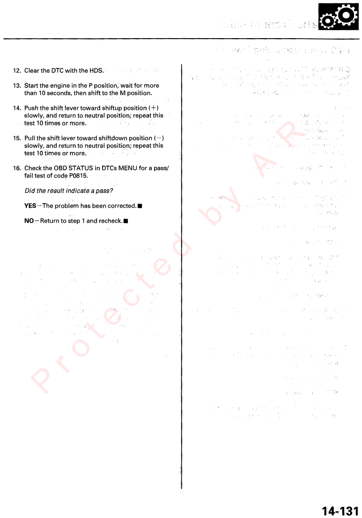

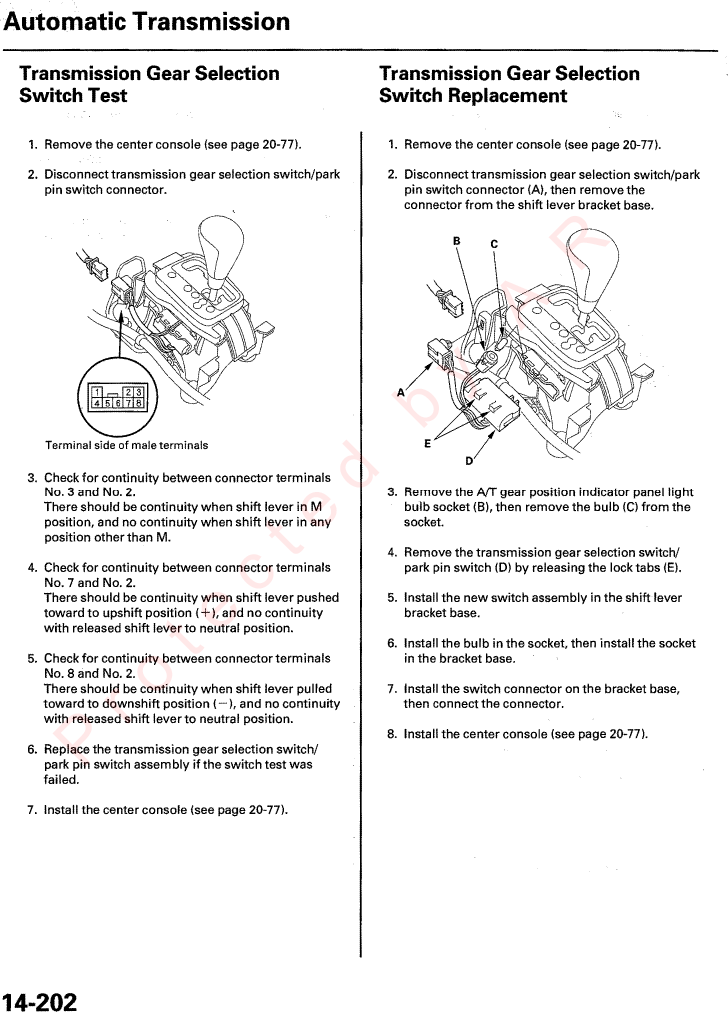

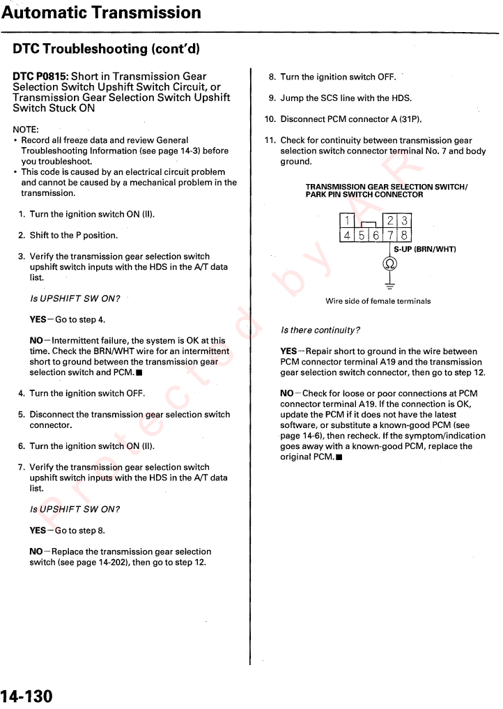

I believe the second bullet point in the Note section of the first page of the diagnostic will please you. But read everything nonetheless.
