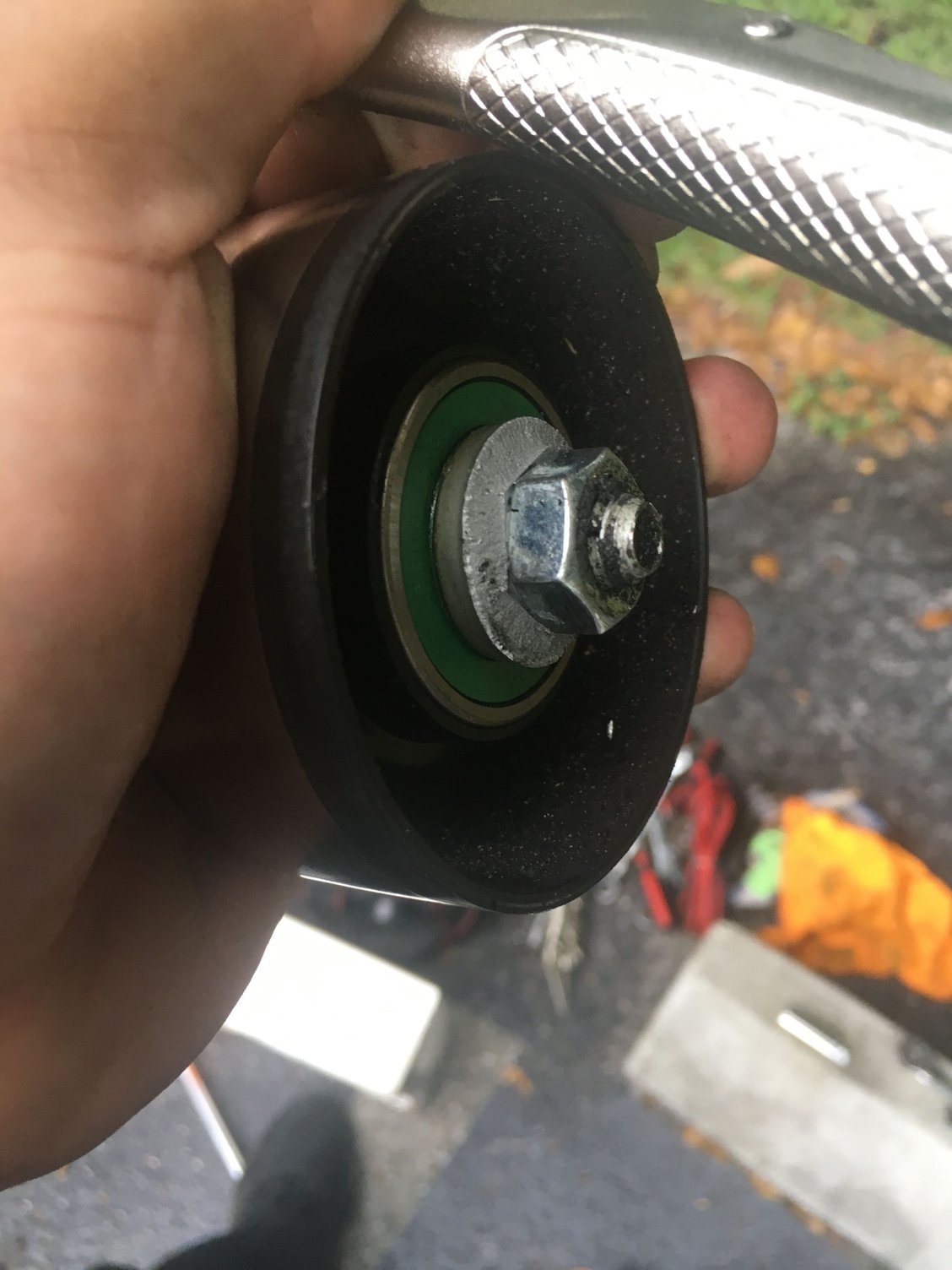

So I tried to take the tension off and it was the tensioner metal that gave and broke (under the nut you see part of the tensioner). Last time I’m buying any major parts from autozone

so you broke the bearing dust cover washer. I just replace my tensioner assembly on the TL-S yesterday.

Well the tensioner metal is what broke, instead of the metal holding the nut in place so I can release the tension it decided to break away, I guess it was cheap material what ever they used. Replaced it with a dayco tensioner with Gates belt, what did you put on ?
