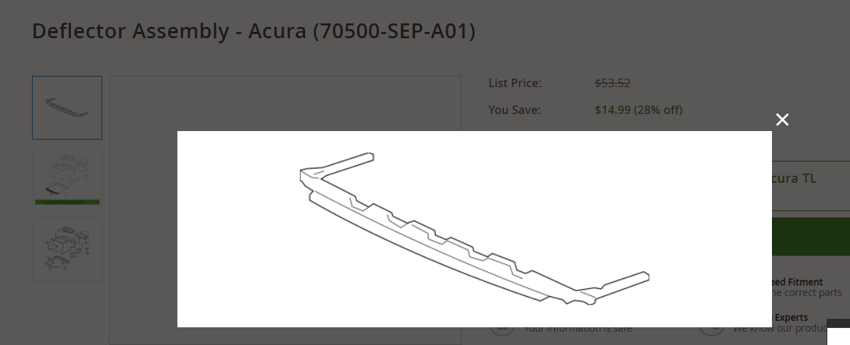

If that is #21 Drip seal, on the link below, it appears to go at the back of the #1 drip rail assembly?

It might be the piece highlighted with red marker in the attached photo.

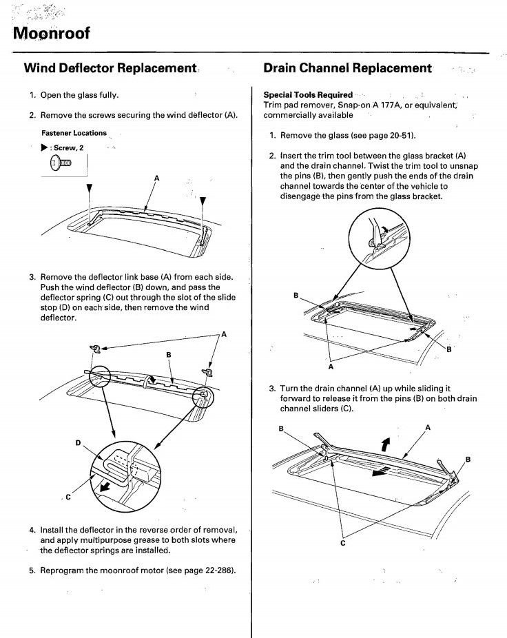

After looking at the manual again and looking at your photos, Zeta and Redbeard, it seems to me like this thing is part of the deflector itself. The rubber connects to the deflector somehow. I'll fiddle around with it.

It may be easier to install if you remove the deflector. Removing the deflector seems easy (pages 20-52 from 2004 FSM).
