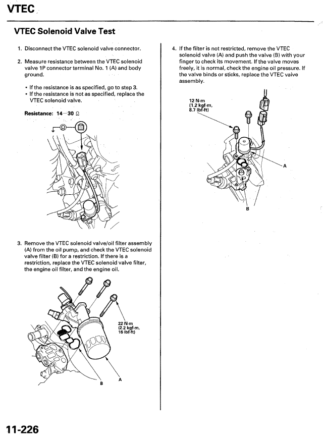

VTEC doesn't kick in? Have you checked the VTEC solenoid?

Yeah, I have reset the ECU a few times in the last week or two. Doesn't seem to make much of a difference. I'm also going to check the VTEC solenoid as well, but i'm pretty sure the issue does lie with the exhaust :
