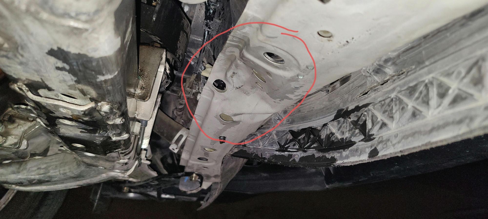

So over the weekend I went through the hell of replacing the oil pan on my 2005 TL. Let it sit for a couple of days and then took it for a test drive yesterday. Tonight I pulled it into my side drive so I could double-check that there weren't any leaks. Put my hydraulic jack on the front subframe lift point and started to raise it. Emergency brake was engaged and rear wheel chocks were in place.
Just as it reached the top of its range, I heard a thunk followed by the sound of coolant draining all over the place. Panicked, I stuck my head under the car just to see that the jack wasn't on the subframe lift point, but was instead several inches forward circled in red. I still need to go through diagrams to see WTF I damaged, but if you know what that part is, I'd appreciate it.
I've jacked my TL's up hundreds of times, so I started thinking how the hell this could have happened. I put the jack back on the lift point and started to raise it. Every few pumps, I looked under the car to make sure it was still on. I think what happened is this...
My side drive has concrete slabs with seams between them. Normally, when you jack up the car, the jack's wheels slowly slide toward the rear of the car as the jack positions itself at maximum extension. However, this time the front wheels of the jack got stuck in one of the perpendicular concrete seams. So instead of sliding back, as I continued to raise the car, the jack slipped off the lift point and landed on the metal "bracket" right below the petcock/radiator drain. The part where it's dented is now pressed right against the radiator petcock/drain-plug and as best I can tell, that's where all the coolant drained from.
Any thoughts on where to begin or parts I should be thinking about?

Should be #9 https://www.oemacuraparts.com/v-2008...diator-support
aka lower radiator support, time to hit up a local junkyard and find a crashed (from rear) to salvage from unless you wanna pay new.
any 04-08 TL should fit

TY! I saw that part but wasn't sure it was the the replacement. Do you think I should replace it with a non-damaged one or try to bend it away from the petcock or take it to a body shop to do the same? This TL has 187K and I don't care about the structural integrity, assuming this part has any impact on that.

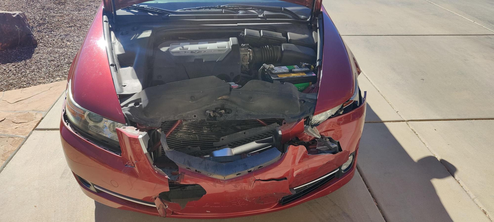

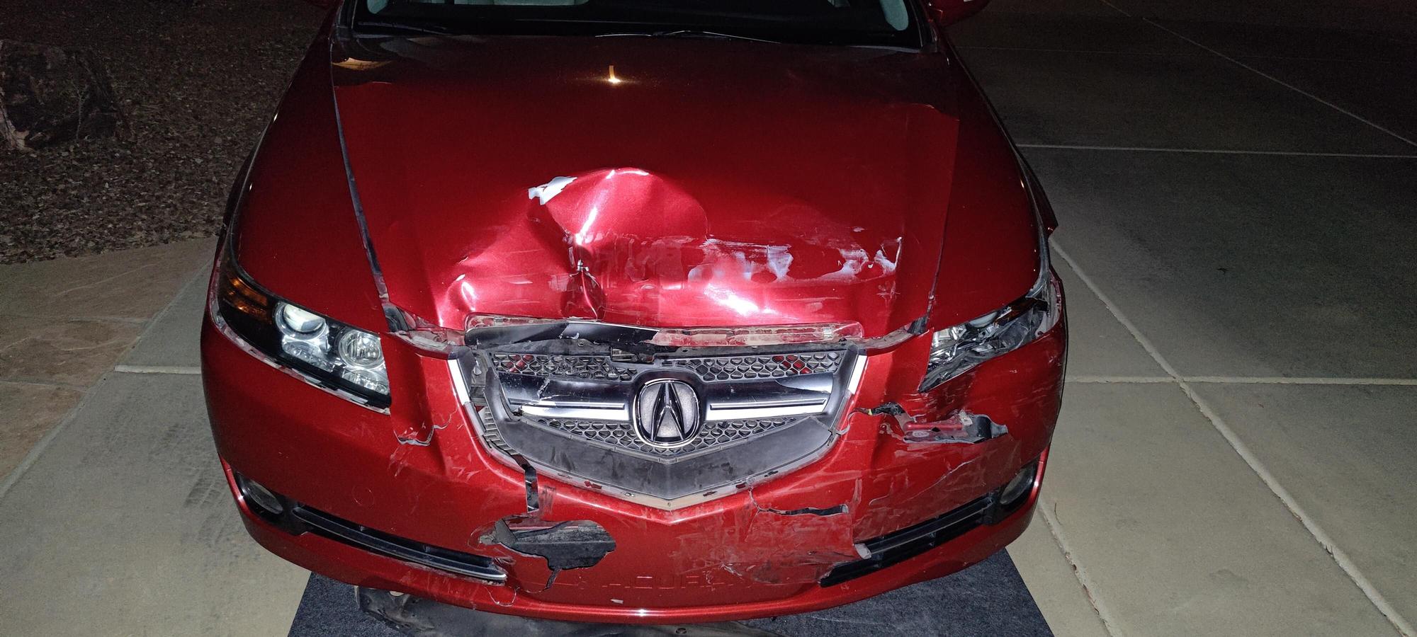

RIP for my 2008 MRP?
I'm always concerned when my kids are out and they call me while they should still be driving as I fear it will be the dreaded, "I'm fine but I was just in an accident" call. Obviously, there are much worse outcomes, but I got one this morning 10 mins after my son left for work, and it's not pretty.
I bought this TL as a salvage title for about $8K in August 2022. Has just under 95K miles on it. I typically avoid salvage/restore, but I saw the pics from the insurance auction where there was only minor cosmetic damage to the rear driver-side fender. I think it was totaled because it had triggered driver side airbag deployment. Interior is in awesome shape and no dashboard cracks at all. It drives (drove!) great.
From the original photos he sent from the freeway, I thought it would definitely be totaled, but looking at it closely when it got home, there's no structural damage. The front fenders are unharmed. The hood, bumper, grill, radiator, and left headlight got the worst of it. Dunno about the AC compressor. It turns over no problem and can be driven, but the fender liner in the wheel well is drooping on the tire. Also noticed that while all the doors lock from the fob, the alarm won't arm (or at least there's no "beep" on the second press).
I'll know more when the insurance adjuster inspects it, but anyone think there's a chance they'll repair it or is it too old and not worth enough? I'm also wondering if there might be an opportunity to buy it back and take some time slowly getting the work done?
Old Jan 23, 2025 | 03:24 PM
Posts: 6,909
Likes: 2,211
Looking at those pictures, it appears that the keyless alarm buzzer may just be broken or disconnected due to it's location?
I'd also say that you may be able to bring that car 'back to life' with some salvage yard donor car parts, if up to the challenge?

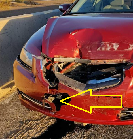

@zeta TY for the feedback! Since USAA deems my TL a "possible" total loss, they want to haul it off to Copart, which is a massive insurance auction lot in S. Phoenix so their adjuster can evaluate it there. I'm going to try and negotiate with the "Total Loss Adjuster" to come to my home instead.
Depending on the numbers, I think this MRP is totally salvageable. I just went out to further inspect it and pull pieces back into place to make it look more presentable (see below).
Ideally, they will agree to have it fixed. If not, I will try to buy it back and fix it myself. The biggest items are the hood, front bumper cover, left headlight, maybe a brace to which the bumper cover is attached, and paint. No structural damage and most of the internal parts, like an aftermarket radiator or even an AC compressor, are relatively cheap.
If they insist on hauling it off, I'm swapping the wheels & tires since I just put new tires on, and I will grab/swap anything else for my 2005 WDP TL.
Stay tuned...

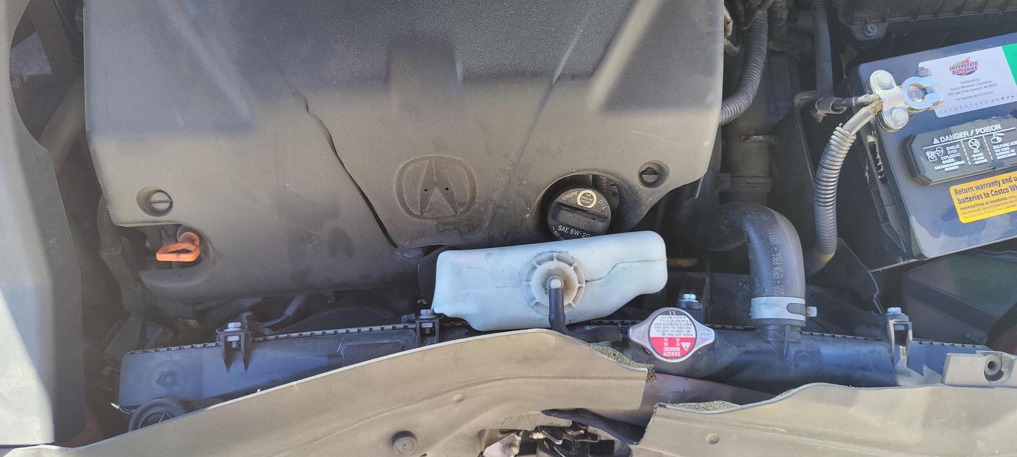

Your radiator is clearly bowed, meaning the radiator support is also bent/bowed. THAT'S going to be the hardest part of fixing this car, since it's probably spot-welded onto the frame. Everything else that you mentioned "simply" bolts onto the car and will be relatively easier.
EVERYTHING is salvageable
Just depends on how deep $$$ you wanna go.
