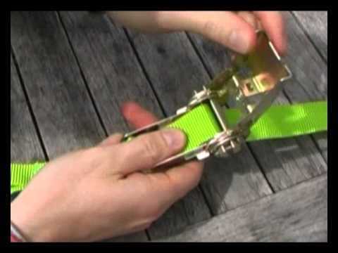

I honestly do not like clamps because they can put uneven pressure on the housing. Last time i did that, I used a pair of strap tightners, the same ones you would use to secure cargo in a pickup or on a rooftop.
Like this the belt will put even pressure across the entire headlight and make sure the seal dries evenly.
