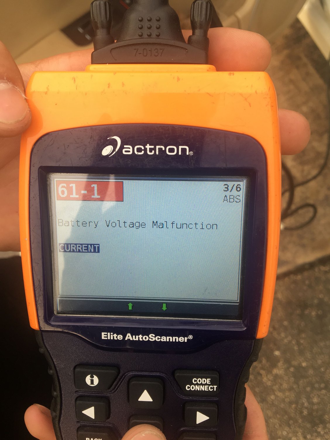

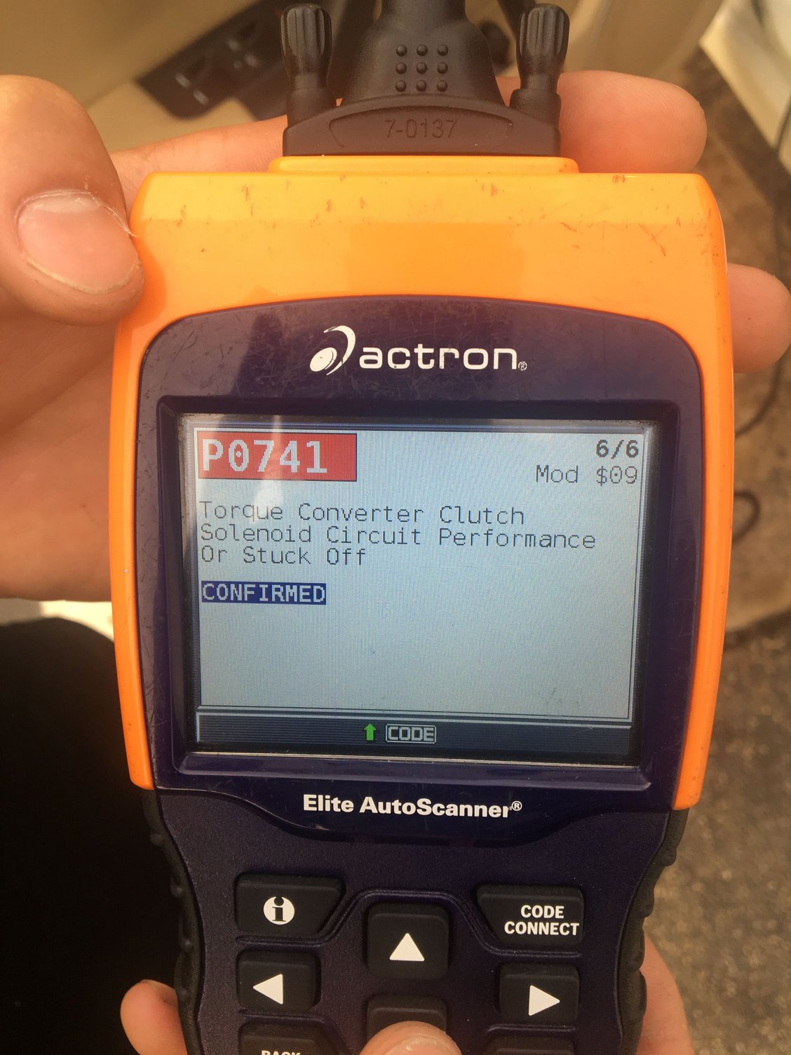

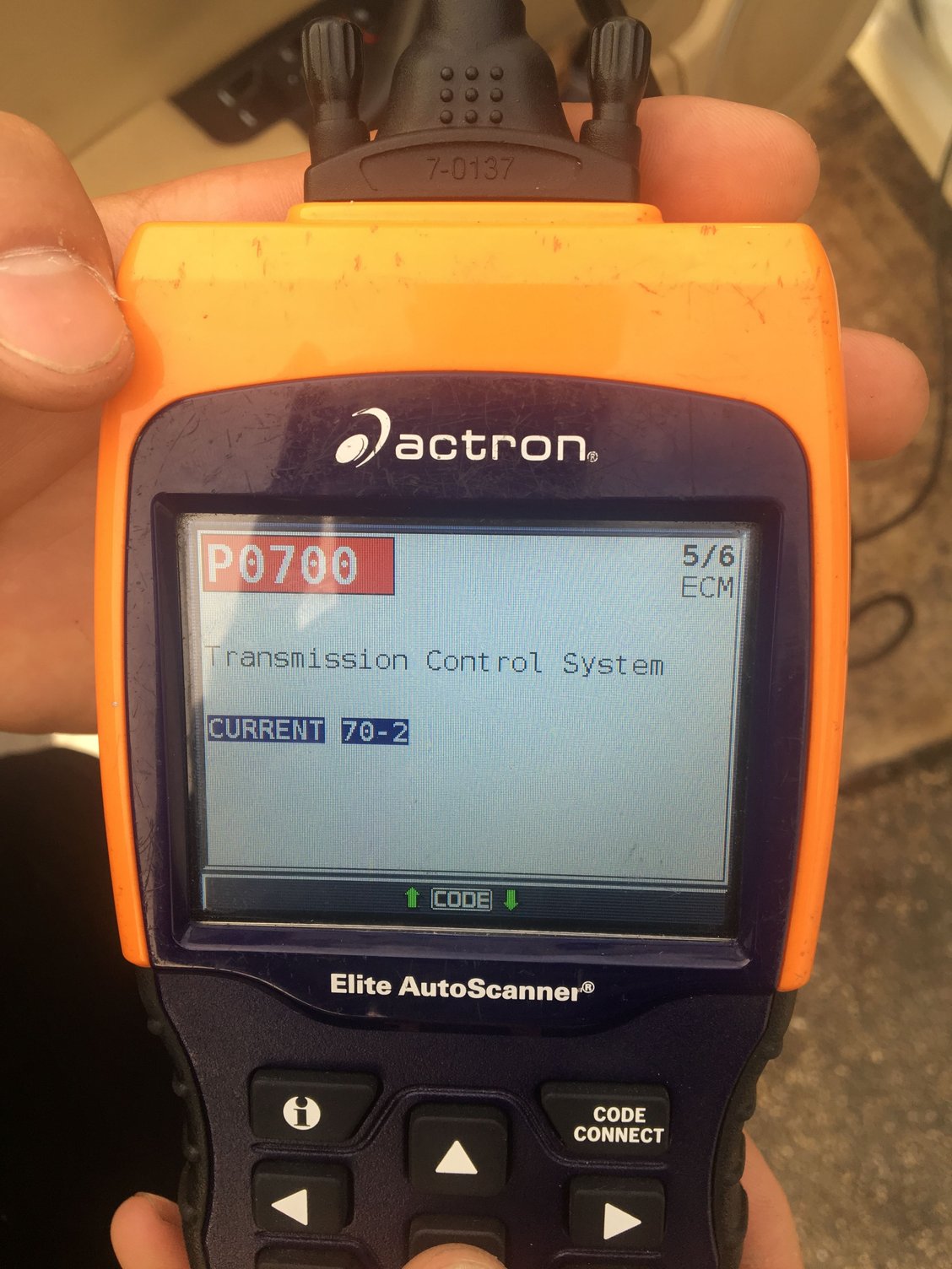

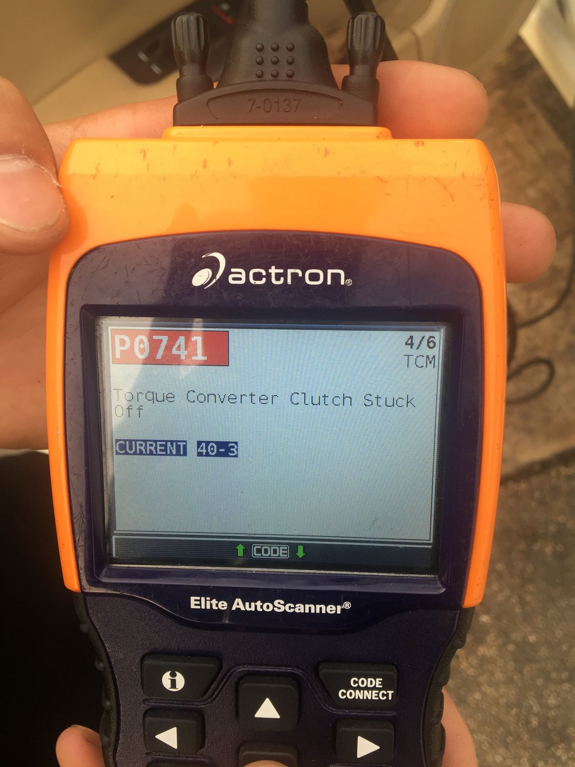

What code is being thrown

Fix that voltage code before you do anything else. Issues with the battery and/or charging system can cause all kinds of random madness.

i believe thats from my subwoofer been there for a while

Check your battery grounds, after that, replaced the torque converter lock up solenoid, its relatively easy to do. and hope for the best, I had the same trans codes, I had done a service when I got the car, road trip, threw the code, replaced the lock up solenoid, test drove and was good, then a week later, another road trip, about 60 miles out of town I noticed the torque converter not locking up, slowed down to take some other road and went to give it gas, nothing. Apparently for the most part the #1 fix seems to be replacement of trans :/ and in my case it was just that >
