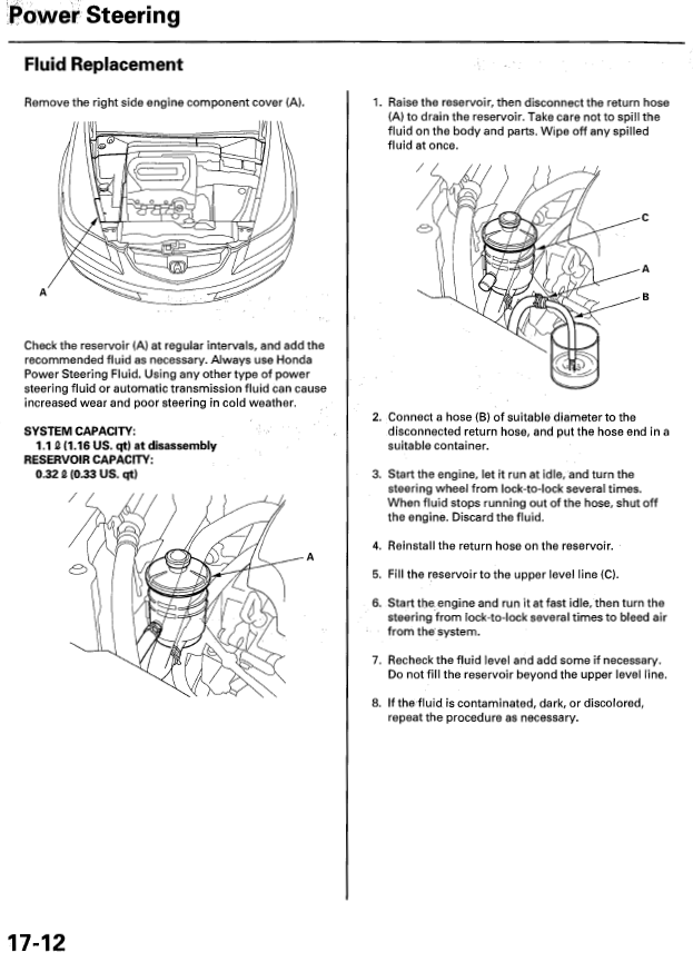

Here's the fluid change procedure straight from the manual:

I worked on it late Sat afternoon, not as smooth as I wanted as I had to clean up a few spills. On the first drain following the procedure, I was not sure it drained much so I filled it with one bottle and run one lock to lock. I replaced the new tank and proceeded to replenish with new fluid, it filled up with 2 bottles and the level settled just shy of the top mark. When I replaced the red cap, I noticed that it was snug. I saw a different post about the same experience in re-using the old cap which to me was in good condition. I will have to run out to the dealer to grab one. I temporarily loosely placed a tape over it so it does not fly off.

What did you use to capture the drain. I know Im going to make a mess, so I need something to catch it all. Oil pan looks to big to fit in there.

I used a gallon jug and inserted the drain hose. I used rugs around the area to control the drips but I have to remove them before the engine starts.
Btw, the nice clear new fluid quickly turned like brown after the fill
