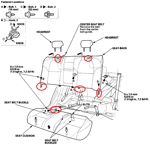

First step is to remove the rear seat so you can access the top strut mount
Circled in red are the 10mm bolts you need to remove
