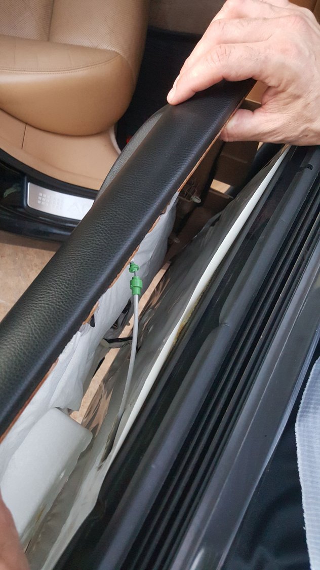

Hey guys. Haven't posted in a long long time. Haven't modded in a long time either. College hit hard. Still only about 95k on my '05

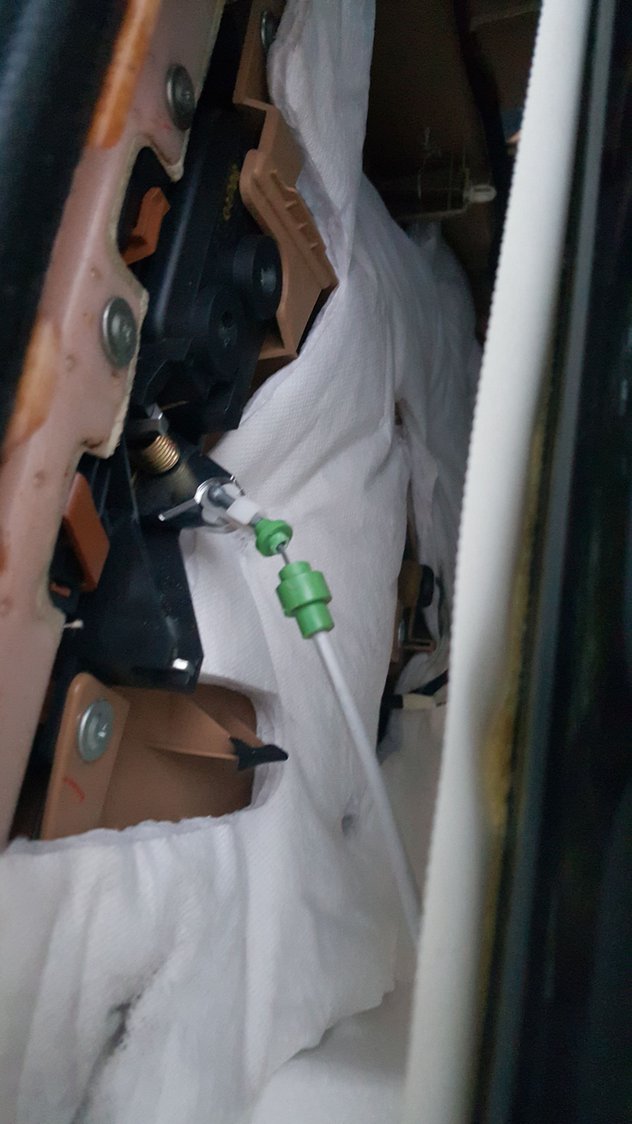

Anyways. Friends always get mad that my rear passenger door doesn't open from the inside. Since its summer, I figured I'd open it up and see why. Turns out there is a little clip that is broken. Easy fix I think. Just don't know exactly what this part is. Here are some pictures:
Inside of rear passenger door
Close up picture of broken part
So is that little green piece.. able to be purchased? This is what I found on oemacuraparts
OEM Acura TL 2005 REAR DOOR LOCKS - OUTER HANDLE parts
I can't tell if #38 looks like the right piece. It almost looks like it should be the little bit that is to the left of #38, but this isn't a part for sale.
Any insight?

Here's a better picture. The description for #38 says it's a fuel pipe clip but it's in the door picture so it must work in more than one place.
I can't tell from this picture but it looks like the two green things at the end of the cable are attached to each other.
If you're real ambitious you could look at the other door and see exactly what it should look like.
038 91591-SJ6-013 CLIP S, FUEL PIPE 002 2005 TL 2.25 1.69

I might have to open up the other door. I guess I can just order #38 and see if it works. Just wanted to see if anyone else had similar problems. Don't even know how a thing like that can break!

I don't believe it's #38. The detached two piece green part? That's actually 1 piece, which is attached to the cable. I learned this the hard way when I opened up my Accord door panel; those pieces are pretty brittle over time, but I haven't seen those break unless someone actually opened the door panel.
The way it works is that there should be something that holds back the green part when you pull the door lever, with the clip clipping into where the green part broke off. I forgot where the attachment was, but see if you can find it attached to the door panel in the area where the green part lines up. If that's intact, you may have to replace the whole cable, which I haven't done myself, but I've heard can be a pain to change out/

Agree. They get really brittle. An Acura tech broke one of mine replacing a drivers door window regulator under warranty. He told me about it since they didn't have the replacement part and I had to make another future apt to fix it. The other thing that gets brittle is the clip (#38 I think) that goes around the green part of the cable to hold it to the pull handle (thing you pull to open door from inside). I broke the clip myself on the passenger front door. Zip tie took care of that. But since you broke the actual cable housing end you probably need a new cable. I'd bet you could rig up something good enough with what you have now.

The part number you need is 72631-SEP-A01
$5.34
As mentioned, it is indeed part of the cable, so replace the cable with a new one and you're good to go!

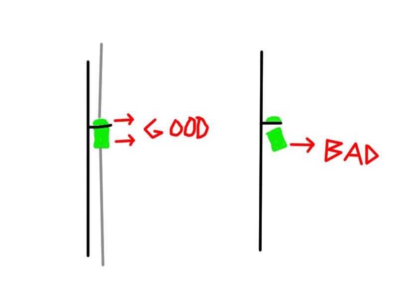

A way of preventing this is to pull the green clip straight out, opposed to on an angle. Pulling it on an angle causes it to rip in half.

Red arrows indicate force of pull

Been offline for a little bit. Thanks for all the replies! I have ordered a new cable.. I'll post pics when it is installed. I *almost* taped it back together when I figured #38 wasn't the right part lol
