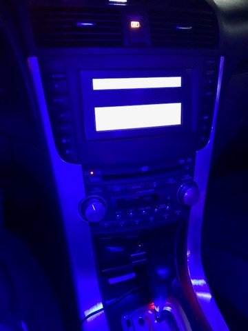

Hi, recently purchased an acura tl 2006. Its my first car so im still new to all of this. Fixed most of my problems with the car using this forum and you guys are really helpful. However I cant fix the radio. The problem is it doesnt ask for the code, I also have the little paper with the code on it. It does have power because the blue backlight turns on with the car. No letters or words on display tho.
Climate display works and buttons as well, airflow works but a/c doesnt which is another problem i have to get sorted. The time above that also resets. Ive read thru many threads but all of the threads are either a blown fuse which i checked and replaced, and nothing. Another thread addresses the radio asking for the code, but the request for the code never pops up. I tried the 1 and 6 -> radio on thing, nothing either. It cant be a fuse because I checked those, and I know theres power being supplied because of the backlight? I also disconnected the battery and connected again and nothing.
Also I opened up one side to check and see if the connections were good and everything was connected. I read in a thread u should reset the fm wire but I couldnt find it, I can post pics if needed. Any ideas? Thank u

Even though theres power to the unit? Backlight is on as well as anti theft red blinking light. Climate control displays & works too..

When you press the power button on the radio. Look at the top display where the clock is. That's where code will show up

The instructions to fix this radoo problem are on page 151 of the owners manual. After the you enter the navigation code on the touchscreen enter the code on the radio itself using the radio physical button's.

I also had this issue and for the life of me I could not figure it out after taking the head unit out and checking all connections and ground.
But this was the solution!!! I AM SO HAPPY RIGHT NOW! THANK YOU SOOOOOO MUCH!
