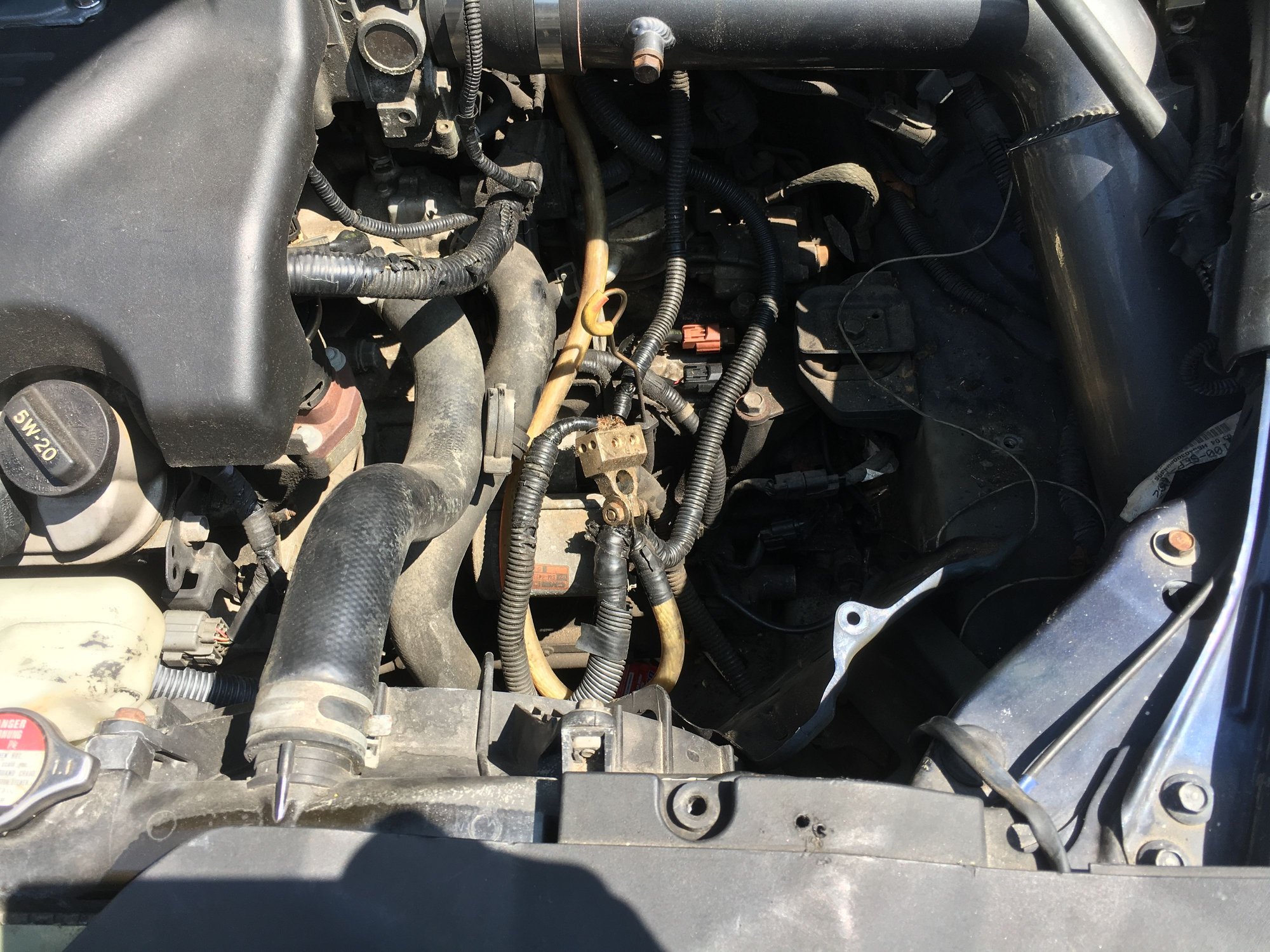

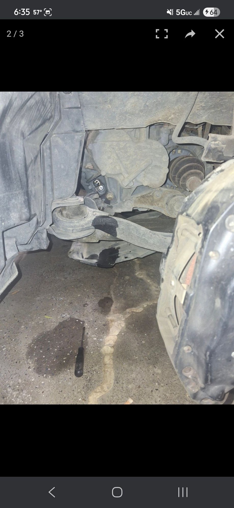

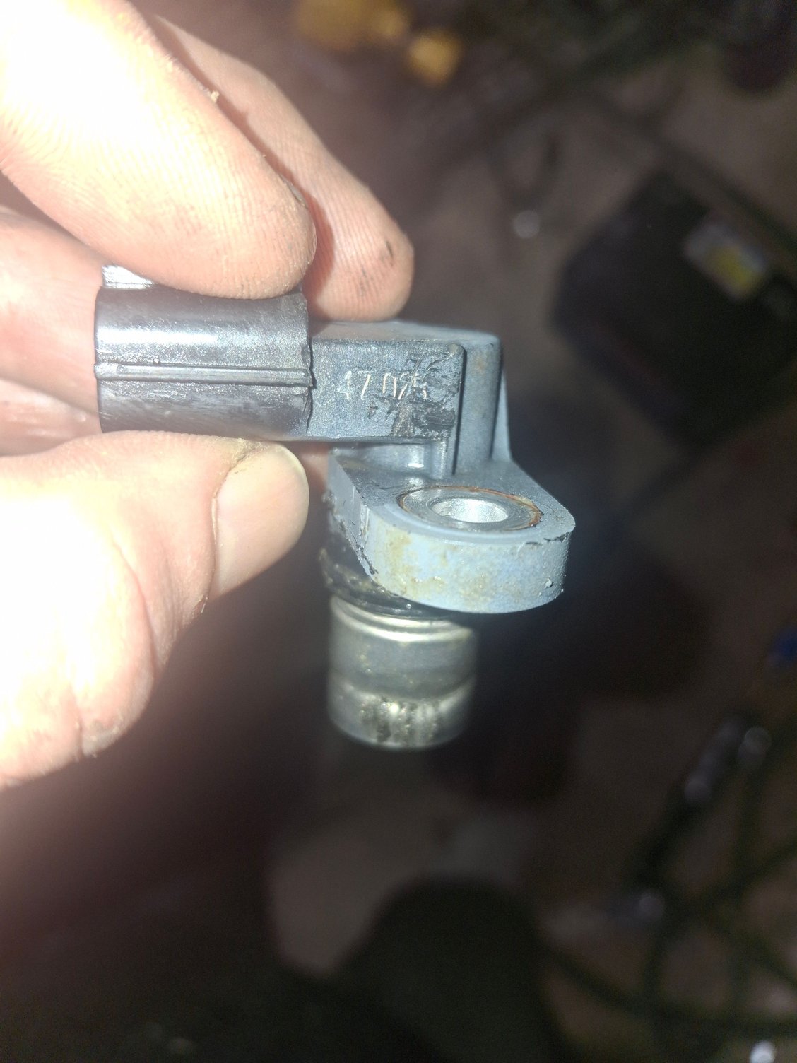

Im super lost because i found something that looks like a speed sensor in the spot that you are describing on the bottom left of the transmission(if your looking at it from the drivers side tire being off) and when i removed it its shorter than the speed sensor i ordered and i ordered the both part numbers for the input and output speed sensors. I posted pics in a post just a little bit ago im not sure if i can post a pic in a reply but ill sure try. Im getting extremely irritated at this whole thing honestly. I cant find the one on top either but i didn't search real long for it.
This sensor
This sensor
I cant tell what the last letter or number is
I can't tell what the last letter or number is
It came from here. There is also one a little bit above this on thats why im lost
