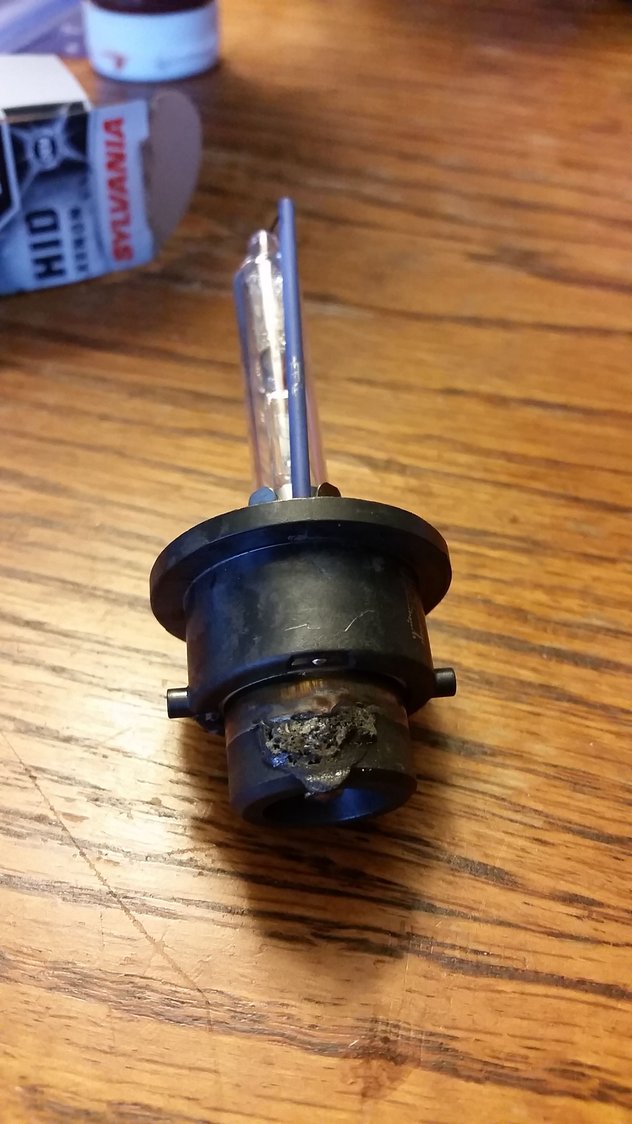

O well that makes sense and was super easy. I did find the problem with my headlight while I was switching them out:
I guess when I replaced it a few years back I didn't seat it correctly and the hid connector unit was fused to it. I replaced the bulb but the connector is shot too I believe. I thought it was a crappy bulb but ends up it was just a crappy installer...
